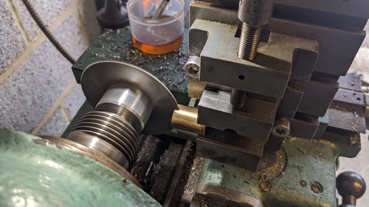

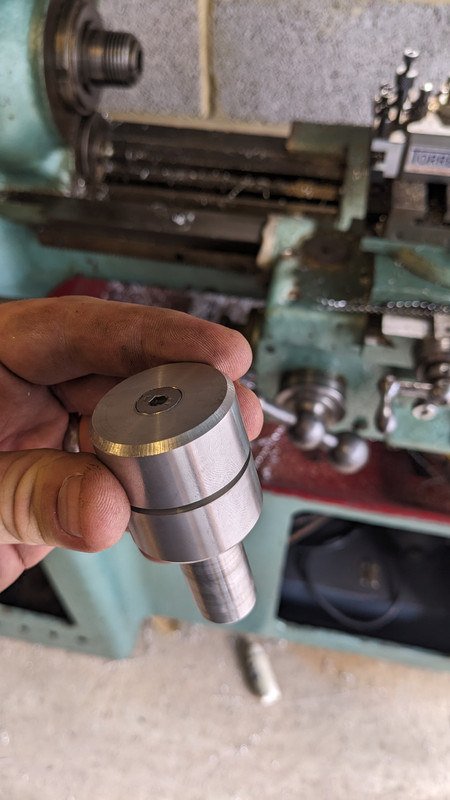

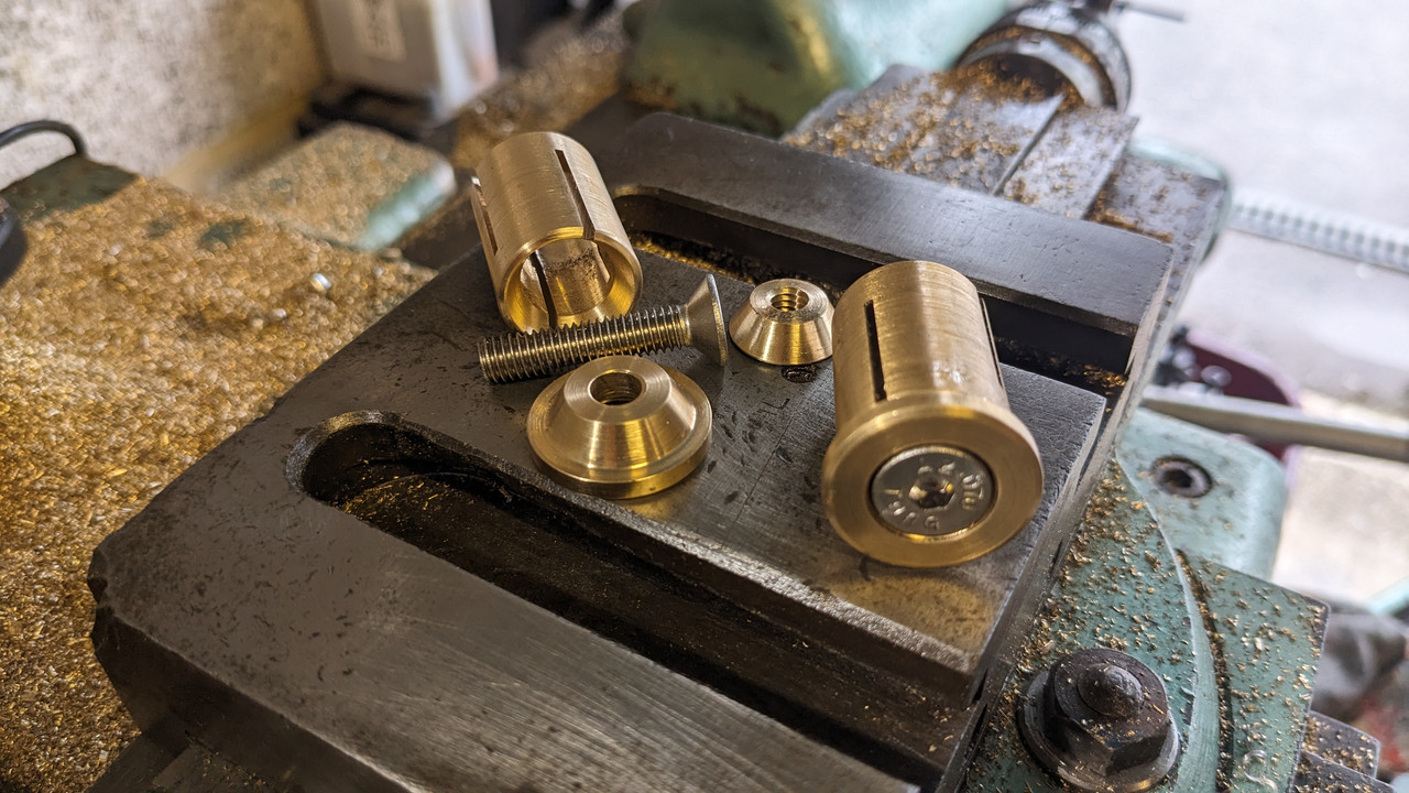

    I wanted to put barends back on my bike but didn’t want to crush the carbon bars.  Rather than buying the £15 Specialized expanding bar plugs I have a lathe and some brass……..
    First needed to make an arbour for a slitting saw
    Then turned the bar end plugs

    Nice slit. Brass can be lovely to turn

    Cheers Mick. Brass is really nice to work with. I much prefer it to aluminium.

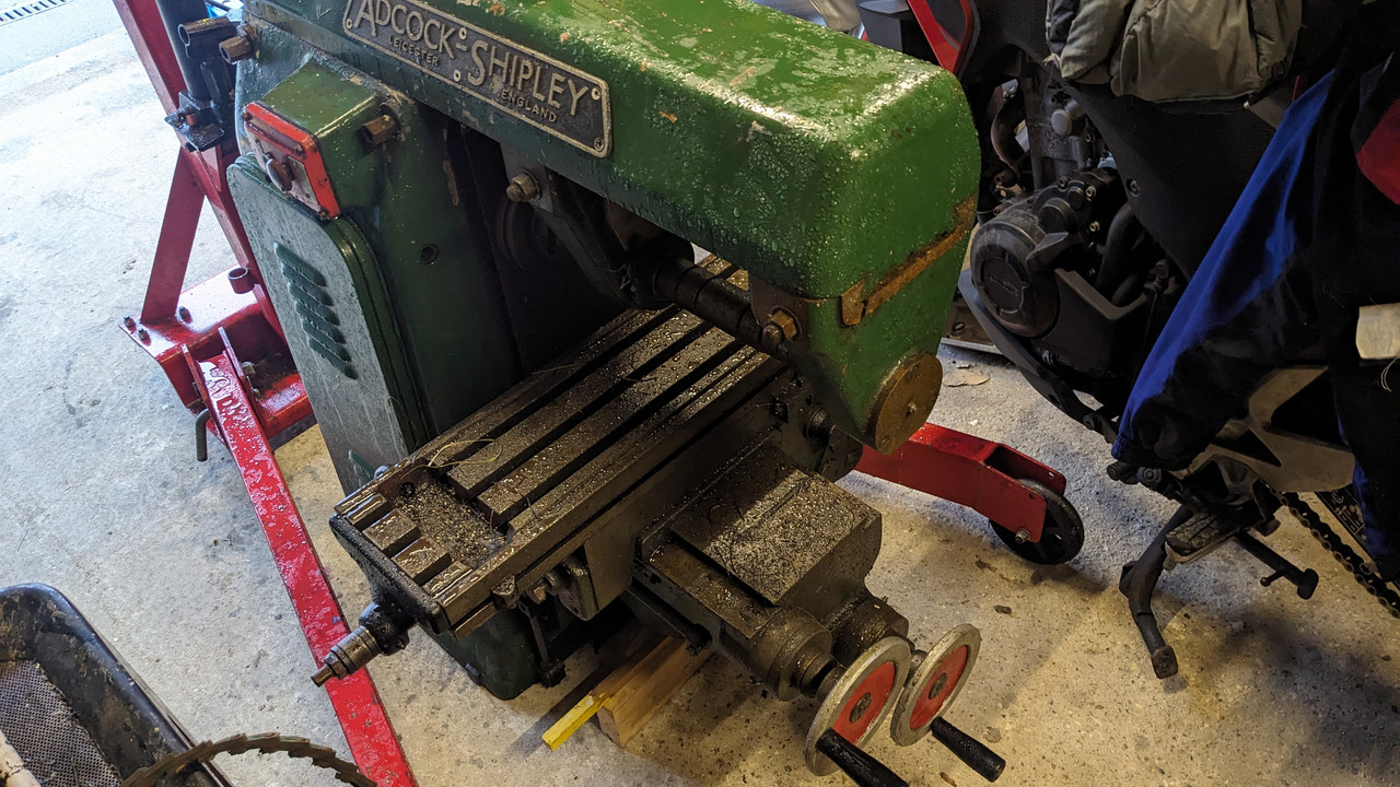

    Slitting and milling will be much easier once I get this machine up and running.
