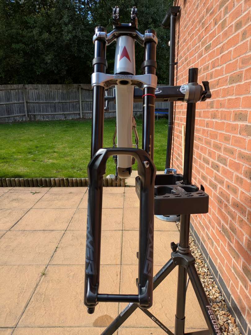

2019 X-Fusion RV-1 DH Coil

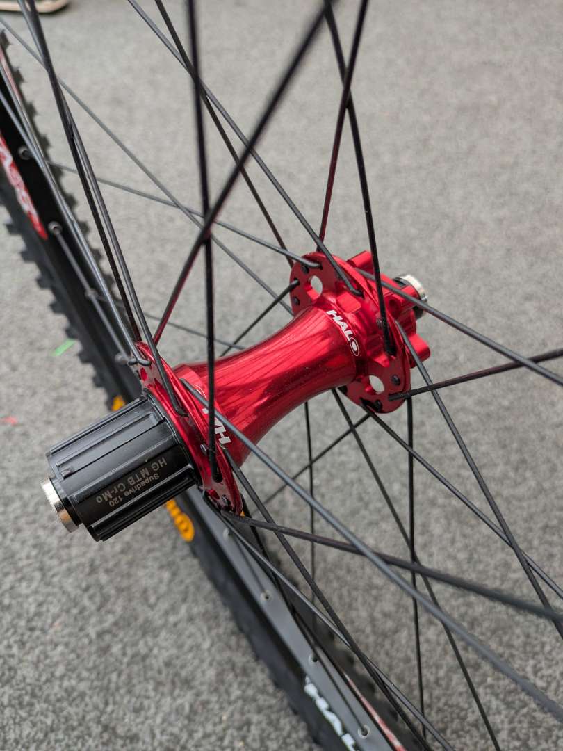

2019 Kore Torsion DH wheelset

Forks came on my Fury and x fusion are great performing. I run Metric RC damper on my mini DH SS AGRO fully. They're unreal comfy

X-Fusion RV-1 forks with Soft spring
Kore 27.5 wheels with Conti Kryptotal F/R

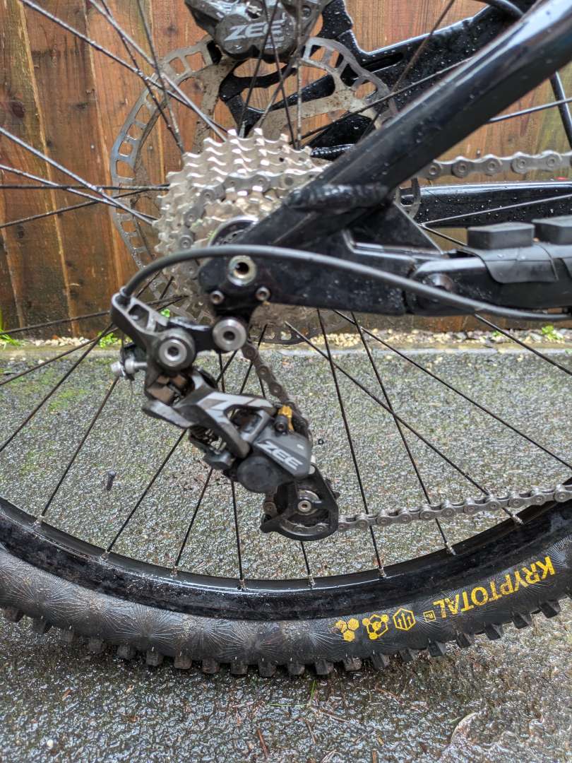

Shimano Saint 10 speed shifter & mech

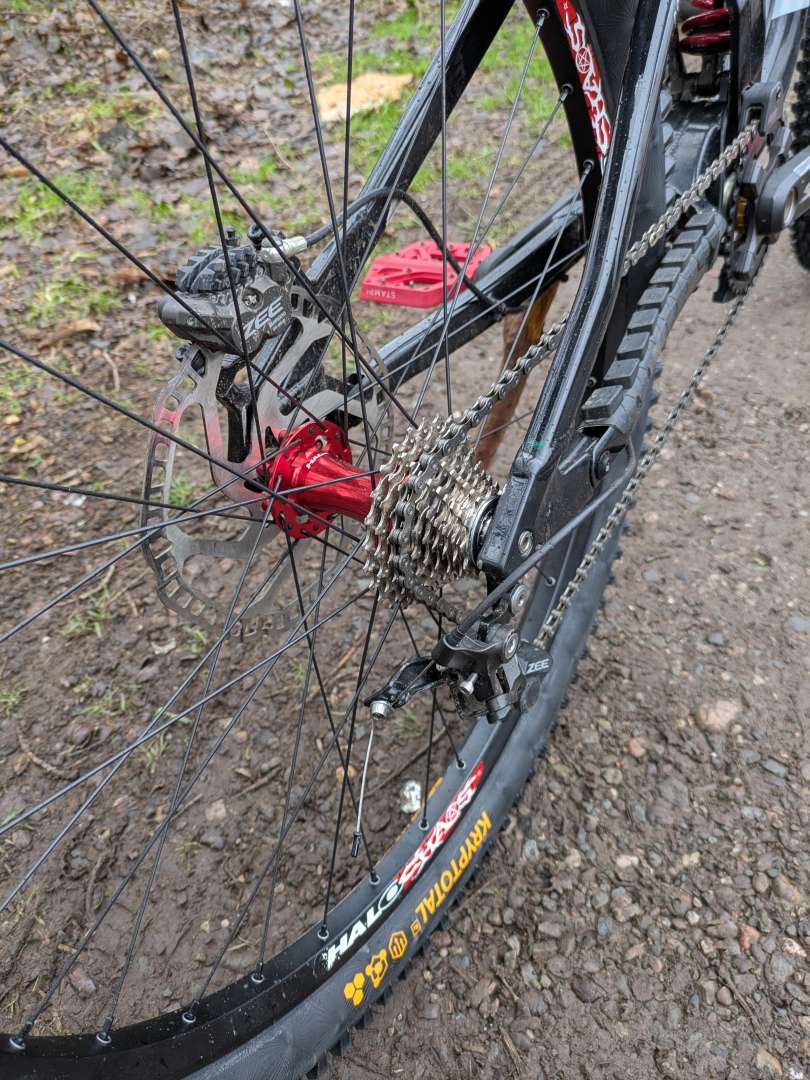

Screenshot_20240624-085304Screenshot_20240624-085325~2Screenshot_20240624-085338Screenshot_20240624-085405Screenshot_20240624-085423Screenshot_20240624-085442Screenshot_20240624-085458Screenshot_20240624-085513Screenshot_20240624-085529
Posted : 24/06/2024 10:01 am
leegee, joebristol, stbennett and 12 people reacted

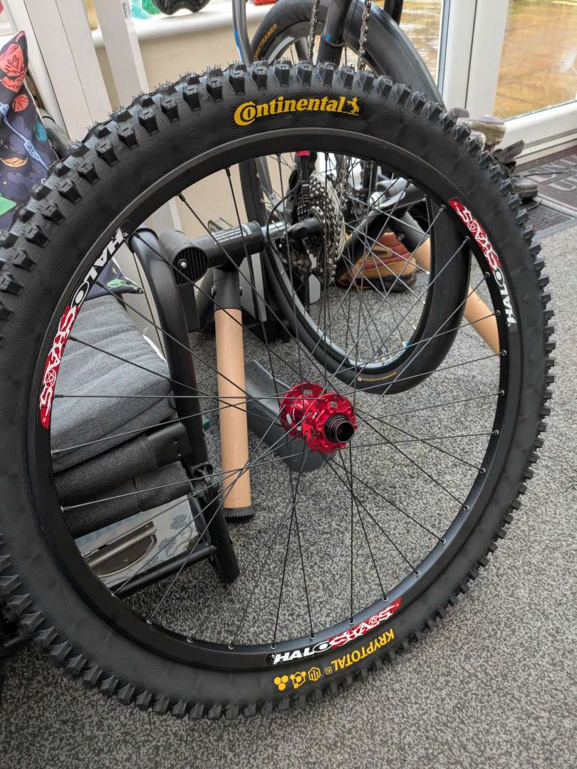

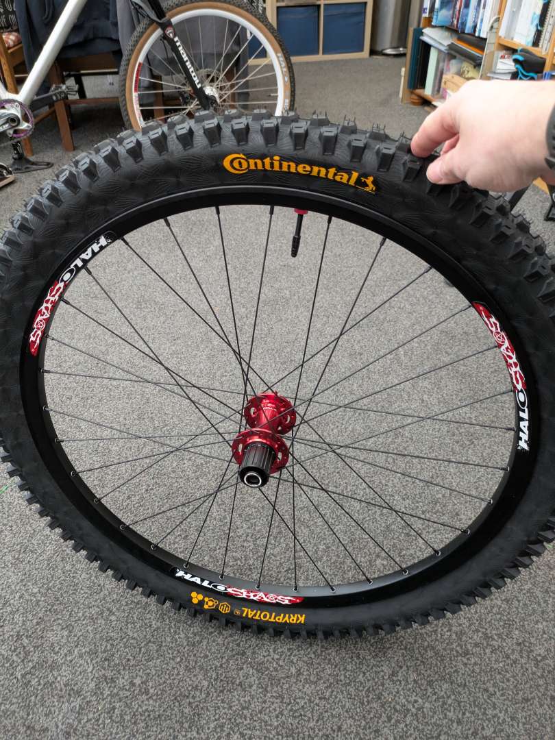

OMG how hard are Continental Kryptotal-b'stard tyres to get on?
Ended up knackering the rim tape on one wheel getting it on - was even harder to get back off!!
A couple of snapped tyres levers and a thumb trapped between bead and rim made for an interesting hour last night lol
Just brakes to bleed and shock to re-fit now.

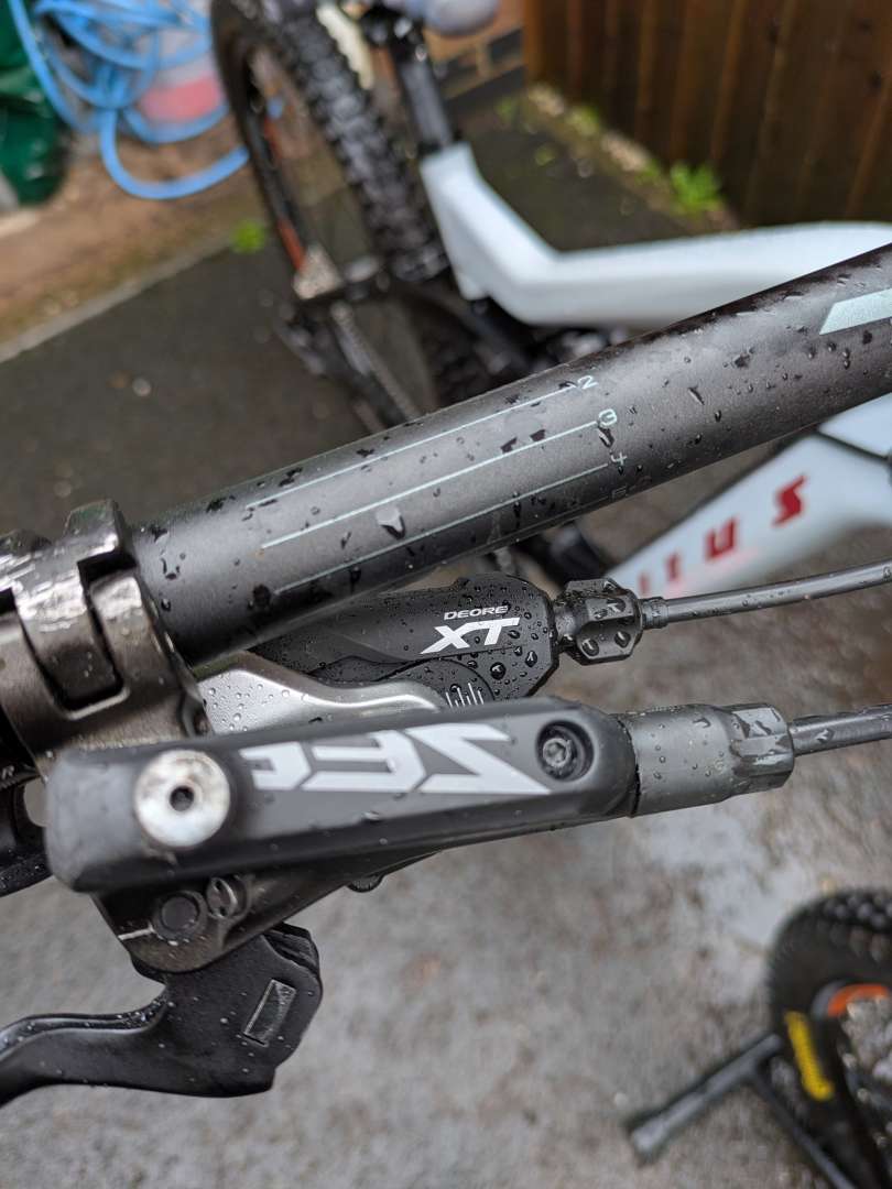

Posts: 1213
Those brake levers are way too close to the grips, don't forget to adjust them for small hands as the reach is also massive on them. I see so many kids riding with badly setup brake levers. For a 'small' person you probably want to cut the bars down a bit as well.
Posted : 30/06/2024 7:55 am
Posts: 3904
Thanks for the comments.
Will sort final lever position once I've bled them and cut bars down.
They're actually more onboard now as I swapped the shifter to the grip side.
Posted : 30/06/2024 10:59 am

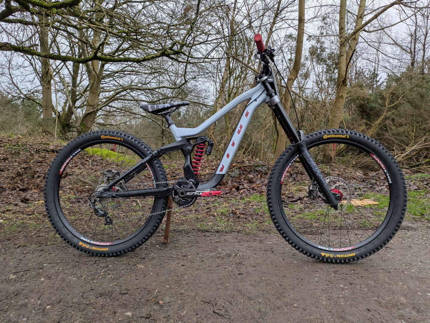

Posts: 3904

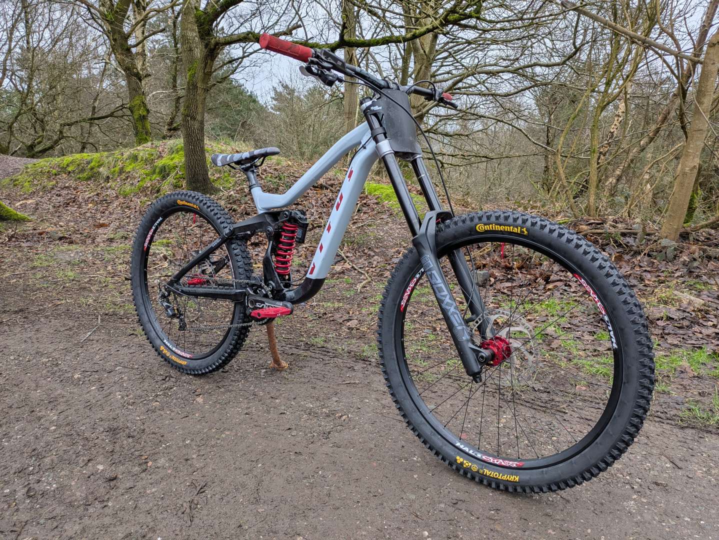

It's finished!!
Well it was finished a couple of weeks back as Daughter wanted it for our holiday to Scotland.
D
Her first ride on it was the skills area at Nevis Range, and then the World Cup track!
Missed out a few of the gnarlier sections and gap jump.
She seems quite at home on the bike, so we also got her a 1/2 day's coaching at Nevis a couple of days later.
By the end of it the only thing she didn't have a go at was the river gap.
The coach was well impressed with her.
Not fast runs but all very clean.
So tomorrow is first race on the DH bike - local race at Stile Cop.
We've been up a few times the last week or so, so she has a good grasp of the course.
We're off to Dyfi in a couple of weeks and then the MIJ races.
All in it's cost just shy of £800, which I think is pretty impressive.

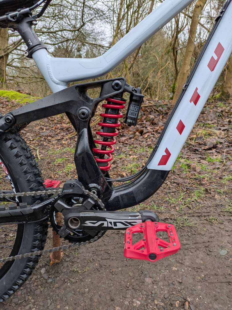

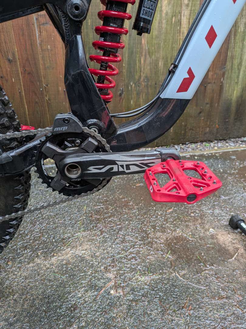

Picked up an 'upgrade' yesterday at the local DH race.
Suntour Voro coil shock courtesy of WC racer Dan Slack (Currently on Pole Racing).
I'll need to fix yesterday race damage first though before we start on the upgrades lol
Posted : 05/08/2024 4:41 pm
Posts: 3904
So we haven't done much to the current bike other than maintenance and messing with fork & shock settings to get a better ride.
It's still riding well and going strong.
It is getting a bit small though.... the joy of kids growing lol

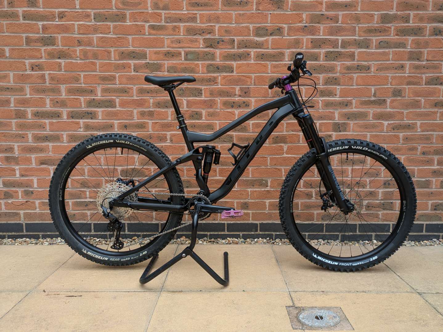

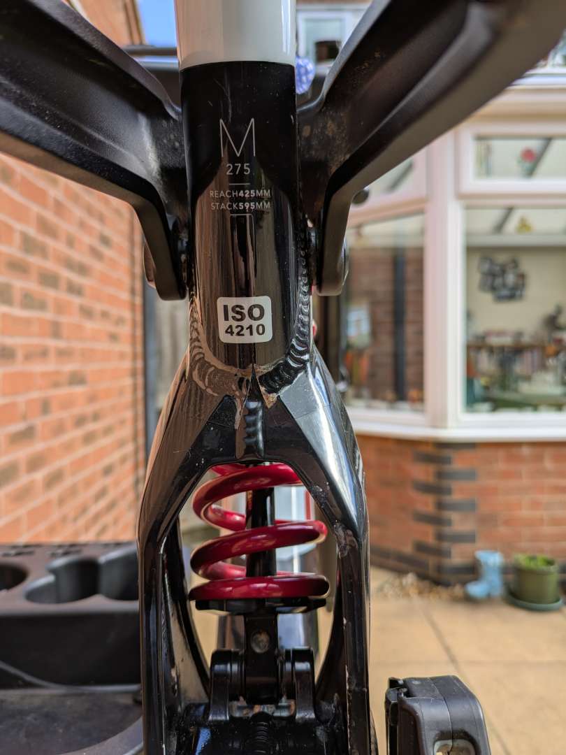

So we decided that by the start of next race season it'll be too small and we'd need something bigger.
I'd enquired about a couple of frames on Pinkbike & a couple of other site but was being messed around so decided to avoid (especially after being scammed over some wheels).

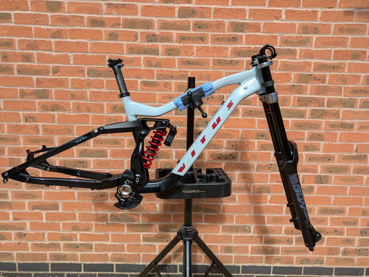

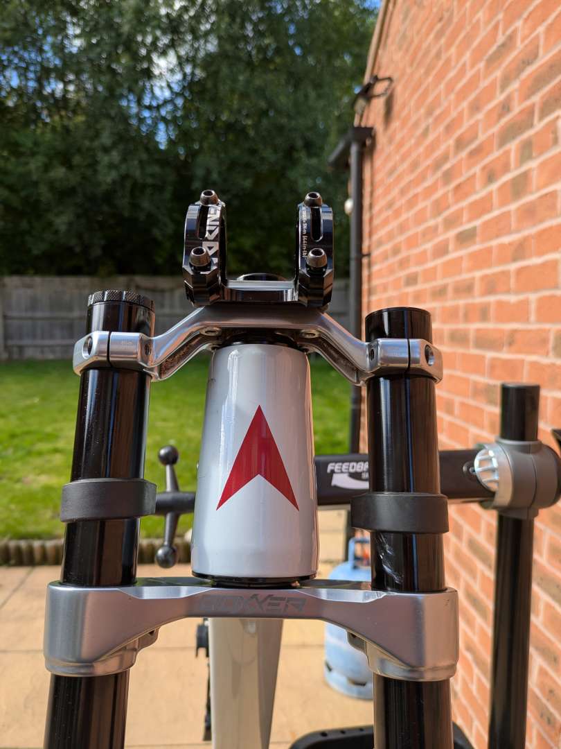

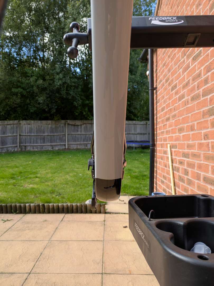

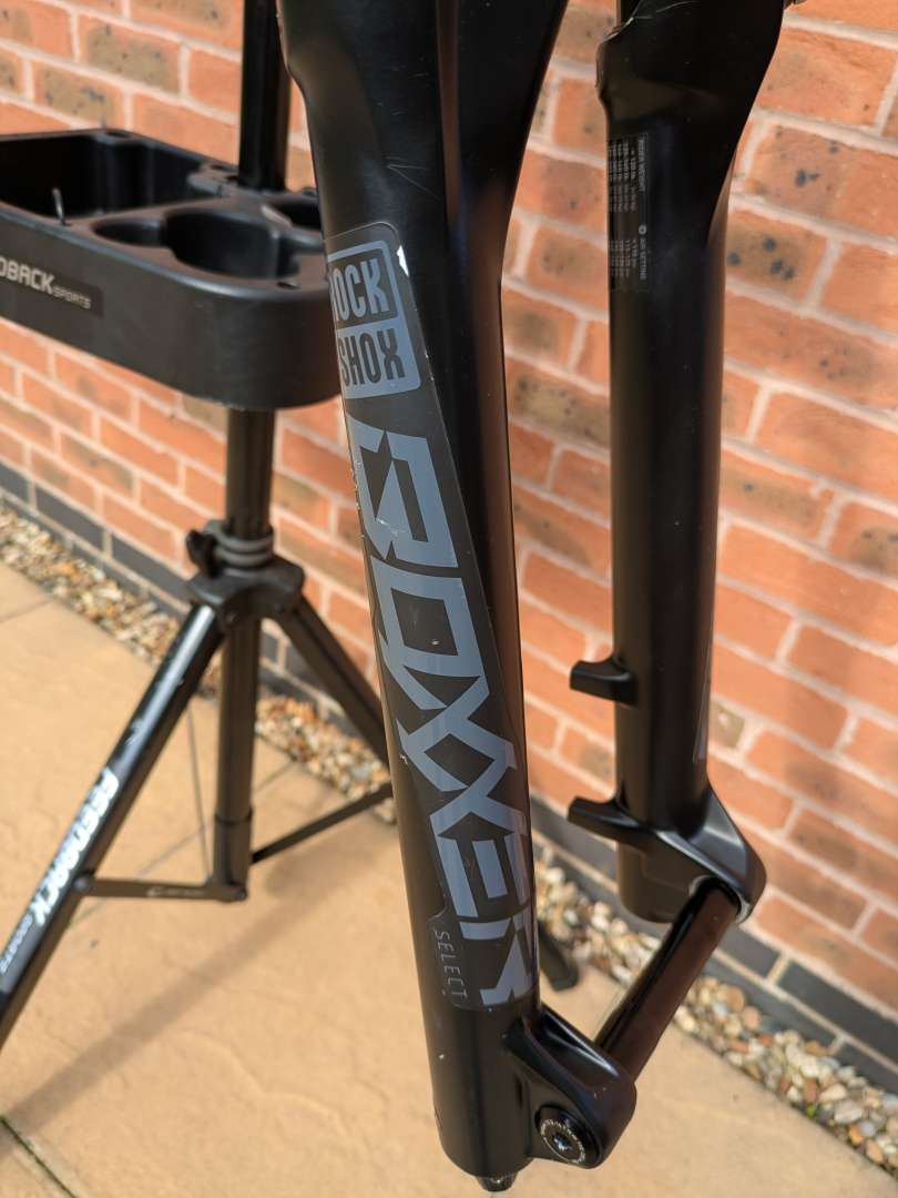

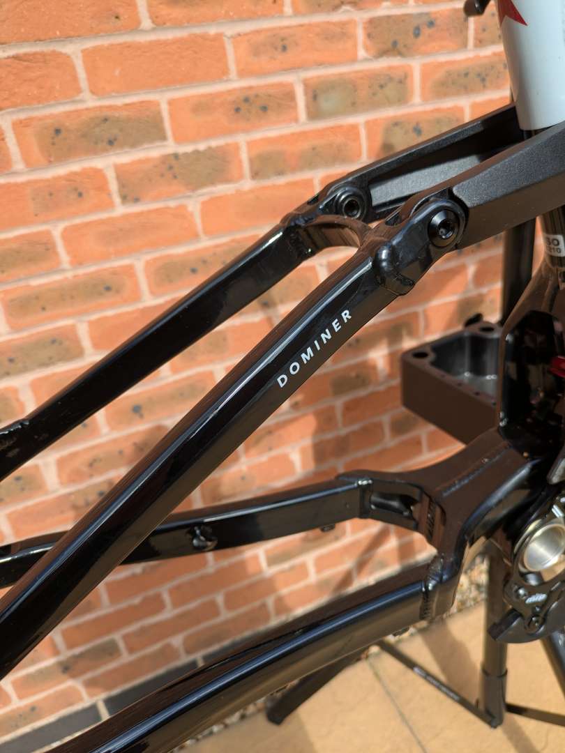

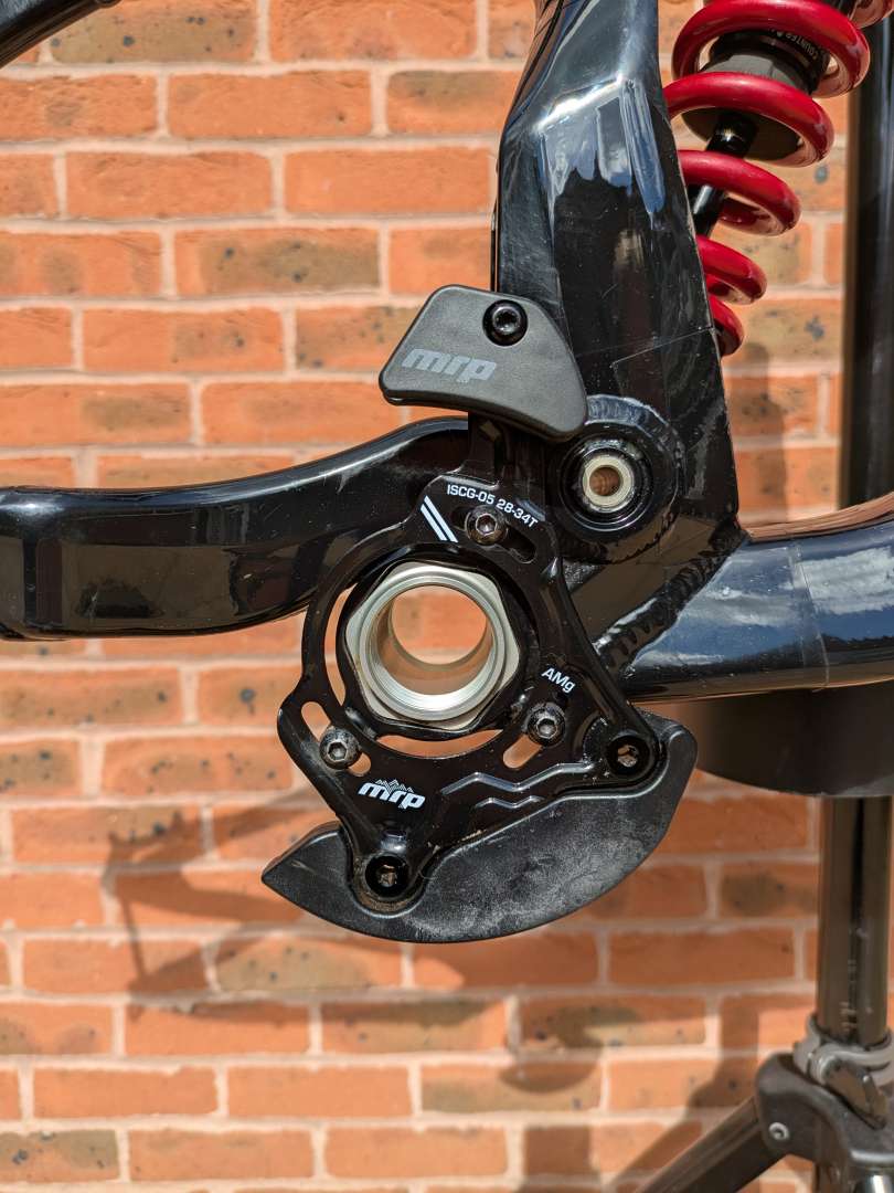

Stile Cop race last Sunday had a few people selling stuff and came across a 2022 Vitus Dominer frame with shock and forks for a not too bad price. I kept looking at it throughout the day and must have bored the seller with umpteen questions.
Well at the end of the racing I decided to see if I could strike a deal.
After a bit of haggling we came to an arrangement, and we now have next seasons bike sorted:
Super clean, invisiframed from new and any stone chips have been touched up.
I've ordered a 275lb spring for the shock, so hopefully that'll arrive fairly soon.
Plan is to swap most of the parts off the current set up and sell that as frame, forks & wheels.
She's going to do the last 2 races on the Commencal and then we'll strip it down and build up the Vitus.

Funnily enough I built her a Sommet (160 Enduro sled) earlier in the year to replace the Escarpe she'd outgrown.

Posts: 3527
Vitus made decent bikes. The escarpe and the more enduro one I forgot about looked like skinny versions of this. Quite simple (in a good way) so should be easy enough to keep running through a season or two
The alu Sommet and Escarpe share the same front triangle. That Dominer front triangle looks suspiciously similar/the same as well!
Those Sommet black on black frames were warranty frames (before the closing down sale) dished out to those who snapped the rear ends of Escarpes (fairly common). A lad I know got one that way! The Sommets have a heavy/stronger rear triangle and don't seem to be as prone to snapping as the Escarpe.

So the new build it (almost...) finished.

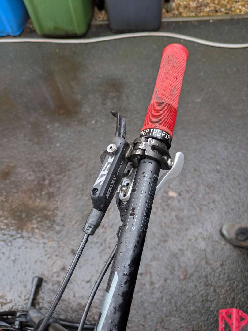

Cleaned after first shakedown run at the local DH trails - it was muddy....
Saint cranks & Crank Bros Stamp pedals
Zee 10 speed rear mech and 11-25 cassette
Zee brakes and XT 10 speed shifter
Tag metals bars and DMR Deathgrips
It's currently running the old wheels off the Commencal build as I ordered the wrong size rear tyre - ordered a 2.6 instead of 2.4 and it's a bit tight on clearance.....
So waiting for another Kryptotal Rear to drop through the door.
Shiny new set of Halo Chaos wheels waiting to go on once the new rear turns up.
It had a bit of work done before the build by Ronan Dunne's race mechanic:
Frame pivot bearings all changed and the Boxxer has had the damper upgraded to the Charger 2.1 RC2 and lighter 275lb spring.
First race outing is in a couple of weeks at Stile Cop.
So far she seems happy with it and it's a big upgrade over the previous Commencal, longer and slacker so more stable and lighter too.
Not weighed it yet but I guess at least 1 - 1.5kg lighter.
I had looked at carrying parts over to the new build, but for the extra cost it was worth going with the new stuff.

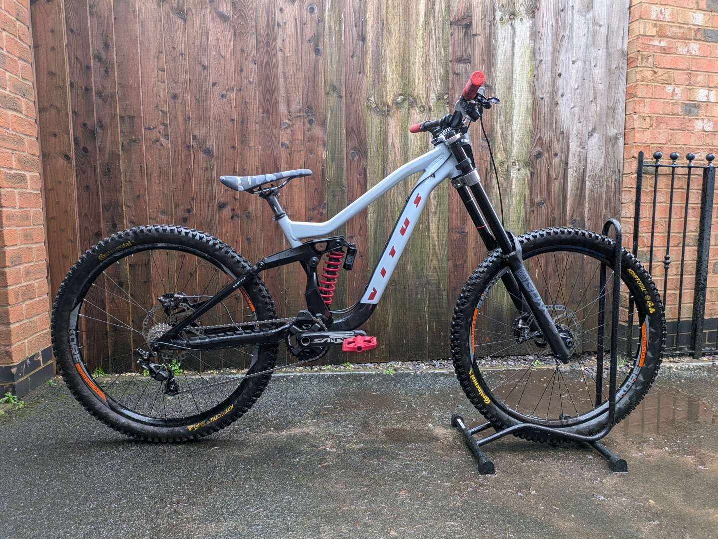

Here we go, final build ready for the weekends race:

Posts: 9281
Nice! Got to love a DH bike, usually overkill for most of what I ride, but there's something so great about having a bike you can just smash through anything on!
Posted : 20/02/2026 8:25 pm

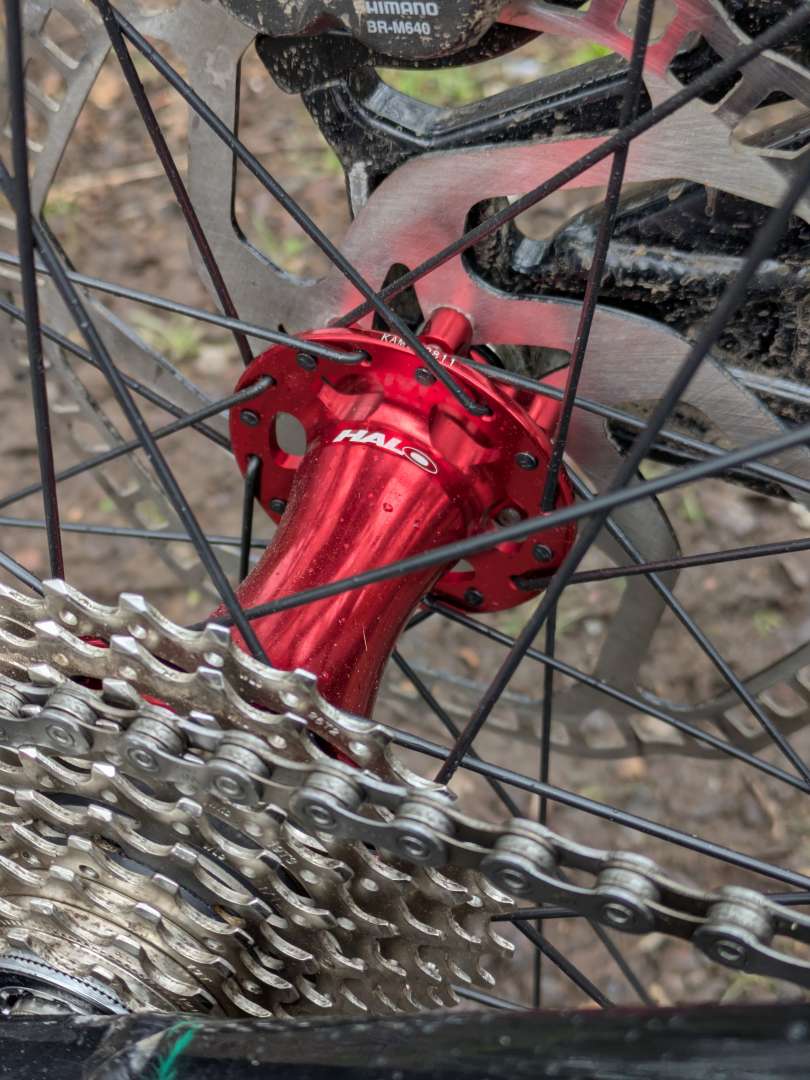

Posts: 3239
Looks awesome, I'd love a DH bike but they're fairly rare so never seem to be available at a price I can afford!
Is the B tension set correctly, just seems as though the jockey wheels are a long way from the cassette.
Posted : 22/02/2026 12:15 am
Posts: 2131
That’s a pretty looking bike. Just the right amount of red on it, not overdone. Hope she did ok at her race!
Posted : 22/02/2026 9:02 pm
Posts: 3904
Posted by: dc1988
Correct, It wasn't - I sorted it before the race though.
