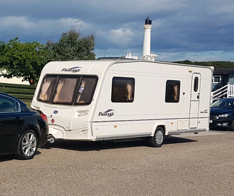

These days especially. Monumental things, longer and longer, swaying about, overtaking me at 70-odd.
Some do have four wheels admittedly, but they still put them all right next to each other under the middle and shit.
Look, this ones massive and only has two wheels, even with what must be a very heavy and unstable chimney.
Why not four wheels then?

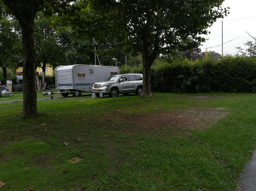

Posts: 14451
I saw one last week in Austria. A BiMobil AX575 aka expensive Swiss behemoth.
Posted : 16/09/2019 7:59 am
Posts: 18003
See now, that's more like it. The majority of caravan places I've seen, you really don't need to do much manoeuvring. It's just like parking it on a drive.
As mentioned above though, I suppose most issues with them fish-tailing come from bad loading but I saw several over the weekend where the rear suspension on the car was so compressed it was like a lowered and stanced car for a youth.😊
Another set of wheels would remove that.
Posted : 16/09/2019 8:04 am

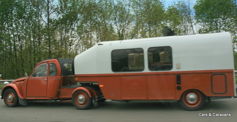

Wheels? Why not use some good old fashioned British ingenuity and invent the hover caravan?
[url= https://i.ibb.co/VtbVG1X/hoversprite.jp g" target="_blank">https://i.ibb.co/VtbVG1X/hoversprite.jp g"/> [/img][/url]
Posted : 16/09/2019 8:13 am
Posts: 4325
Why not add some sort of active steering and perhaps a supplementary drive system?
[url= https://i.ibb.co/NS8rpyD/winnebago.jp g" target="_blank">https://i.ibb.co/NS8rpyD/winnebago.jp g"/> [/img][/url]
