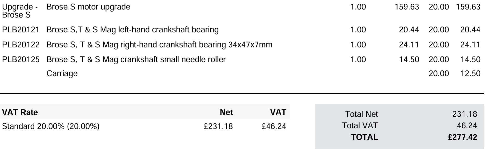

Posts: 14893
This was my invoice for work to my 5 year old (at the time) Brose Motor - very reasonable, although I think prices have gone up a bit now
