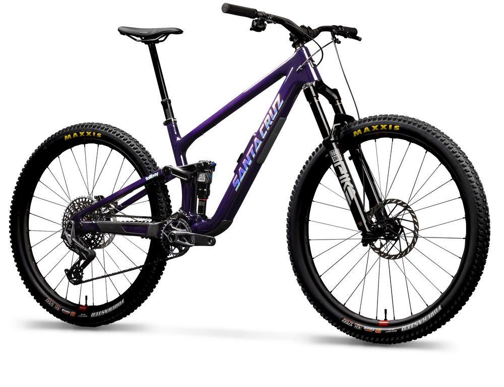

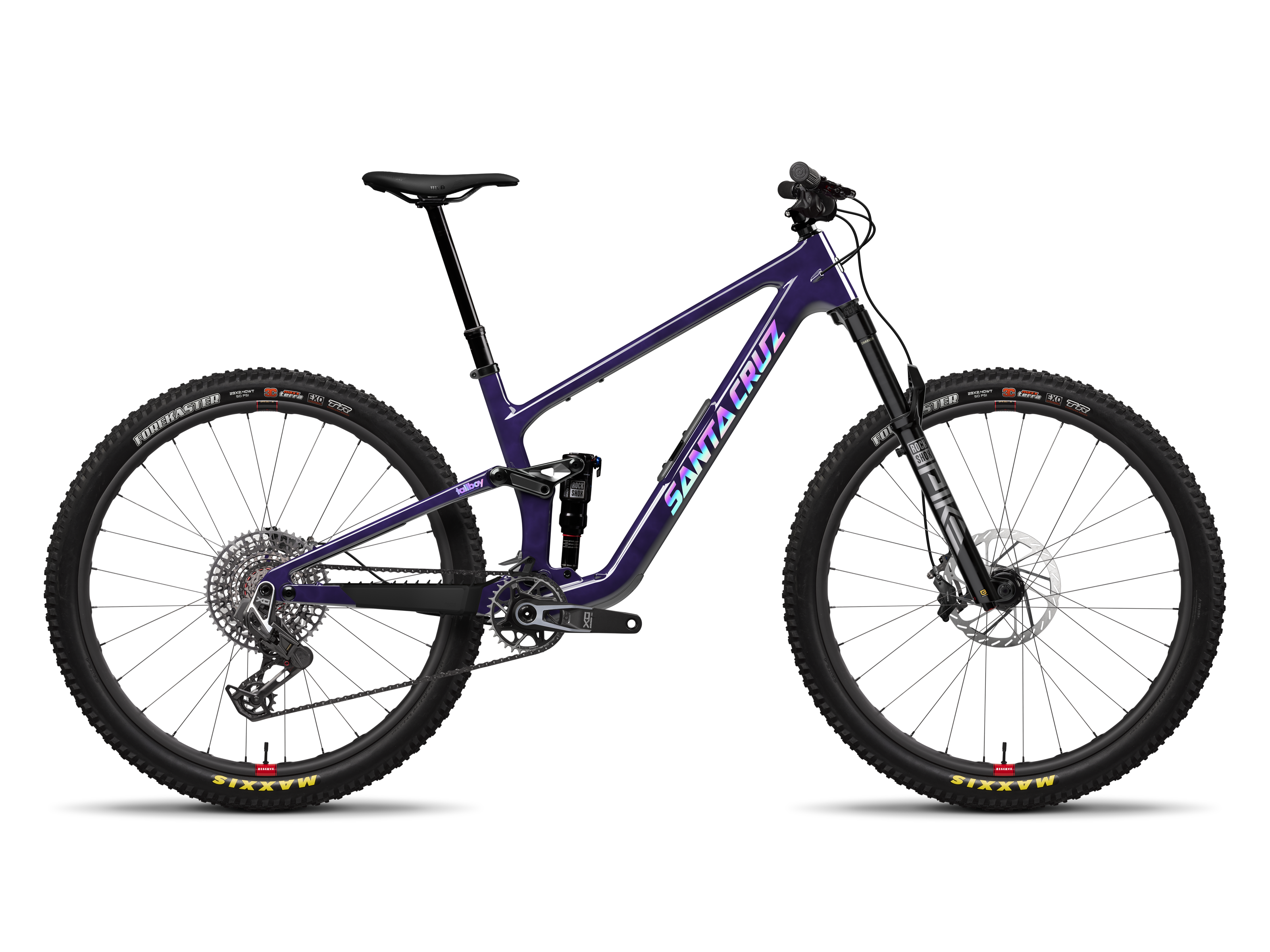

I know there's a lot of Tallboy lovin' on here so this won't be surprising news I imagine. Ooooft:
https://www.santacruzbicycles.com/en-gb/collections/tallboy
No more VVP but that's the way things have been going with other new SC models so entirely expected. Will it matter? Probably not.
Given I've owned two Tallboys and Mrs a11y had a Tallboy LT, I fully expect it'd be my sort of bike. The problem is my current Tallboy 5 is just soooooo good there's no incentive to even consider a change. But in a few years maybe a discounted frame or secondhand bike.
I feel dirty for liking the rainbow/reflective downtube decals though 😛

Posts: 2055
I own a v5 and have done since the launch date 3 years ago ,  Its first real ride was the WestHighland way , and I wouldnt change it for the world  especially for one that now is a cross between a smuggler  privateer 141 and trek.
 The V6 looks awful  in my eyes . The none drive side cable boss looks like a nasty afterthought ..  I wax to much but Im not a fan.

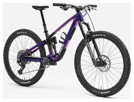

Posts: 46867
Trek called, they want their design back.
https://product-cdn-frz.alltricks.com/large/187/968187/2968187/6520650

"Trek called, they want their design back."
There are dozens of bikes that look like the new Tallboy and are also Horst links (true four bar) but that Trek is one of the few that looks similar but has a different suspension system! 😉
