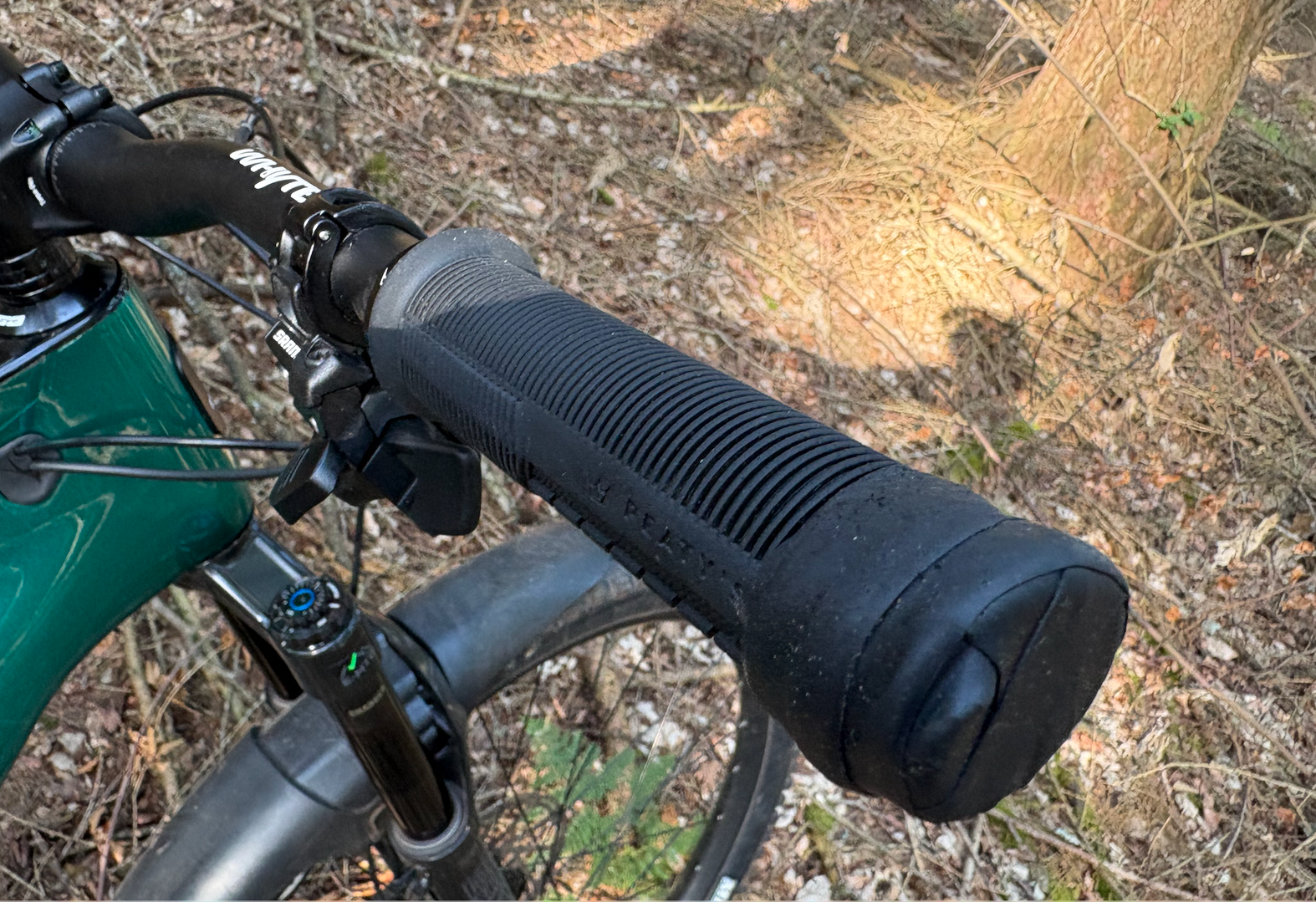

Other than the grip being sacrificed to the God of Tarmac and the bar being shaved by, well, quite a few MM not other damage to the bike. I was going to swap that bar for a carbon one earlier but it was too damn hot. Another bullet dodged. Taped it back u as you can see, went for the ride all good. No issues at all.

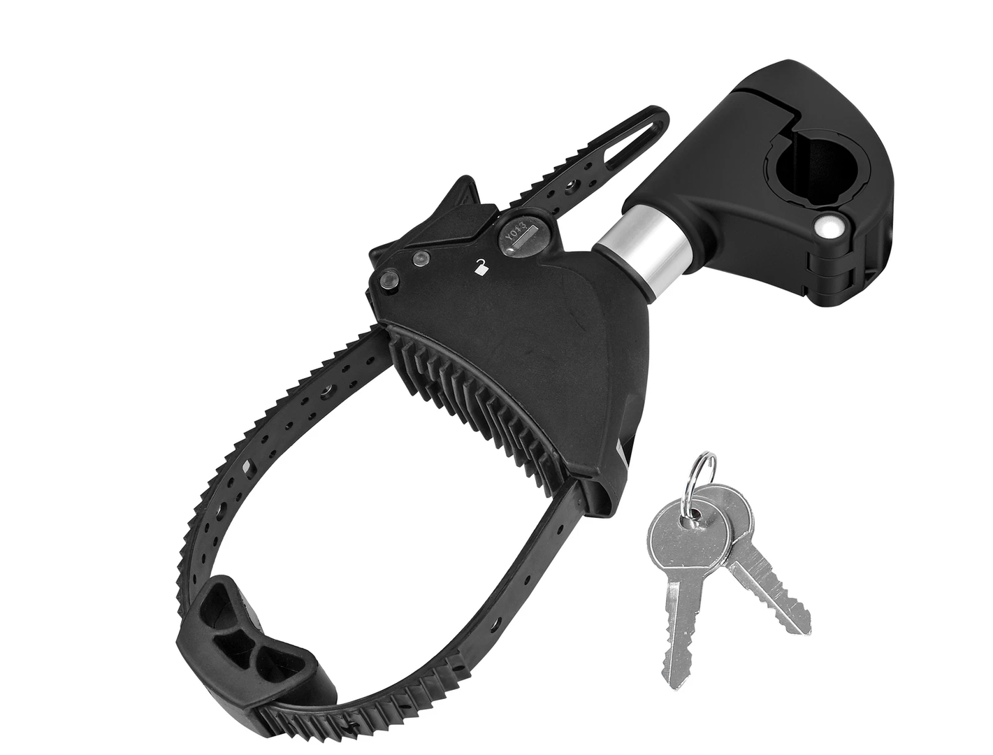

I have replaced the clamps on my Thule towbar rack with the Eufab strap type ones. Mainly cos I never trust the claw style ones even though they are generally solid they always look like they are at a funny angle and one pothole would see them lose grip. The Eufab ones also seem kinder to carbon frames so you're not clamping down on the thin edge of a carbon top tube

@muggomagic - they look like the ones on my old Atera racks. Might be a better option. Also from today I'm going to use the inner of the two placements. Rather lose a rear window than a whole bike!

Yeah those EUFAB ones look ideal - saved them for later
they are great, I have a EUFAB 2 bike towbar rack, it is sold by BMW/Mini as OEM, though you get detachable little stickers that go with the brand that you buy. I got it when I had an i4 which had a very shallow towball, which didn’t work with Thule racks.
Frustratingly the locking mechanism on the carrier itself fell out of it after a year or so however when I raised it with the BMW dealer they warrantied the whole carrier and rack, with the new one having an improved locking barrel.

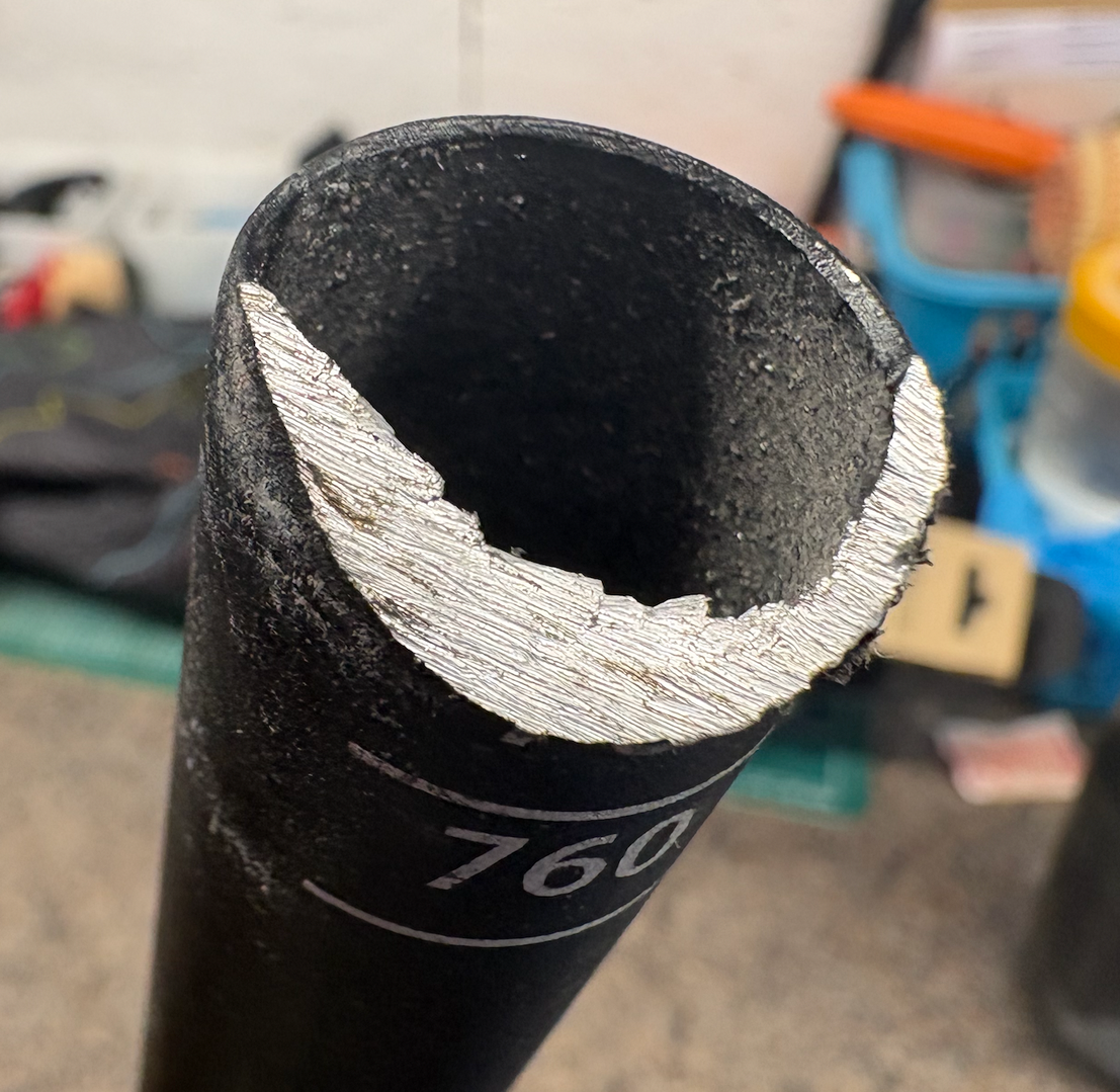

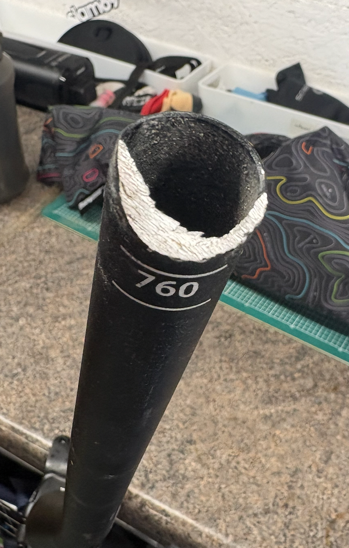

Definitely a bit of road rash. Still they'll make a lovely set of 760mm spares with some hacksaw action 🙂
