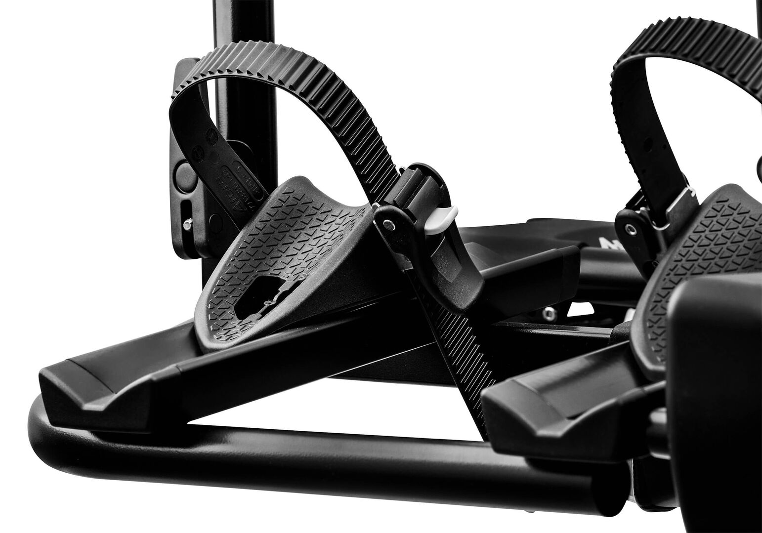

I have recently bought an Atera Strada bike rack. Generally, im very happy with it. The only fly in the ointment is that the front wheel twists to an alarming extent while I’m driving. Since the wheel is strapped in at the bottom, I assume this isn’t a big issue, but it’s still very irritating. I’ve tried running another strap from the wheel to the down tube, but that doesn’t seem to stop the wheel moving  wheel im driving.

I'm not familiar with it at all, but assuming it has a builtin strap at 6o'clock, could you put two others on at 5 and 7o'clock as well/instead?

How hard are you cranking down wheel straps? While my wheel can move when pulled by hand, it does not while travelling along. I really cinch down those wheel straps hard...

Ha. Ive cinched them until I just cant cinch any more. On the Atera, once you reach a certain point, the clicks make a noise, but they don’t actually tighten the strap any more.

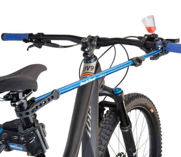

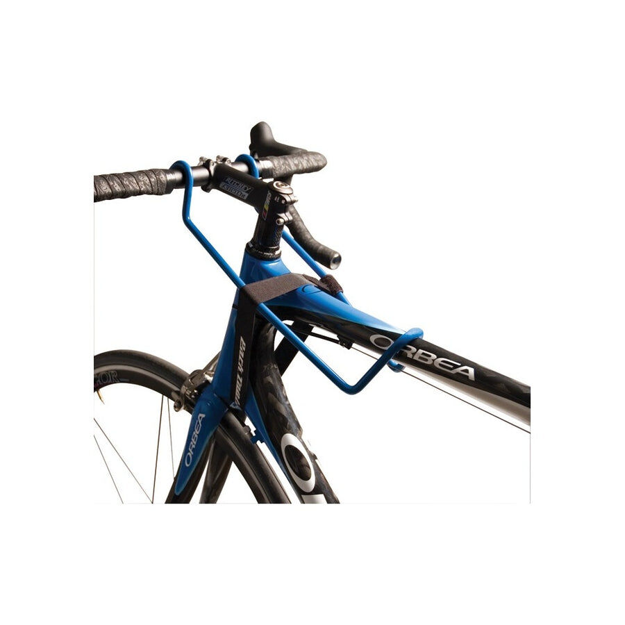

There are some handlebar holders you can buy. Park tool sell 2 different ones.
They might do the job if the straps don't work

Thanks everyone - yes it’s only one bike. Sometimes, the wheel has turned to a 45 degree angle. The Park Tools doodaas look interesting.

Hi, is it a long bike or hanging over one end of the rack more than the other bikes?
I've had this with our Strada rack and similar tyre if the wheel is on/over the end of the alu' tray so that only the plastic wheel mount (movable plastic ramp with the strap) is supporting the wheel.
Solved it with a bit of shuffling to get the problem wheel sitting on both the tray and sloped mount for the shorter bikes so the wheel is better supported.  But, my Cotic (long) is still at the end of the tray and the bars and wheel will still rotate/turn and wobble (mostly backwards - from the air flow past the side of the vehicle catching the side of the exposed wheel).  I have found that if you slightly turn the wheel in the tray when you clamp it down you can get it to seat better and not move, I also tried strapping the wheel to the next one i.e. to the side worked better than strapping it to the down tube but I stopped bothering once I worked out the above reduced it enough not to be a problem.  I also found it clamps down better when the tyre is softer..
Hope that helps!
