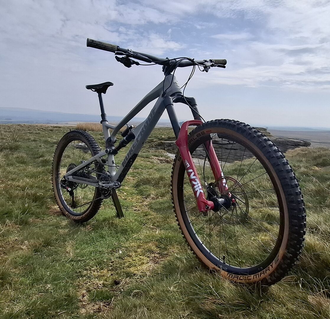

Posts: 2908
 20260426_103319~2.jpg Took my new (to me, second hand) Nukeproof Mega, for a short shake down ride.
Never owned a FS before, and got this off a mate who pretty much gave it to me. It's got the odd scratch and scrape, but 100% mechanically sound.
Needs a tweak to get the fit to my liking,  bar width and stem, different saddle etc. Apart from that a great piece of kit.
Posted : 26/04/2026 1:58 pm

Posts: 3714
Went from 475lb to 550lb spring on the formula mod shock and made some tweaks to the forks and the megatower feels pretty much dialled now. I’ve entered the QECP southern enduro which is next weekend so I’m pleased to have finally got it sorted. Mind you if the weather is as forecast I might just stay in and watch the WC DH and XC.
