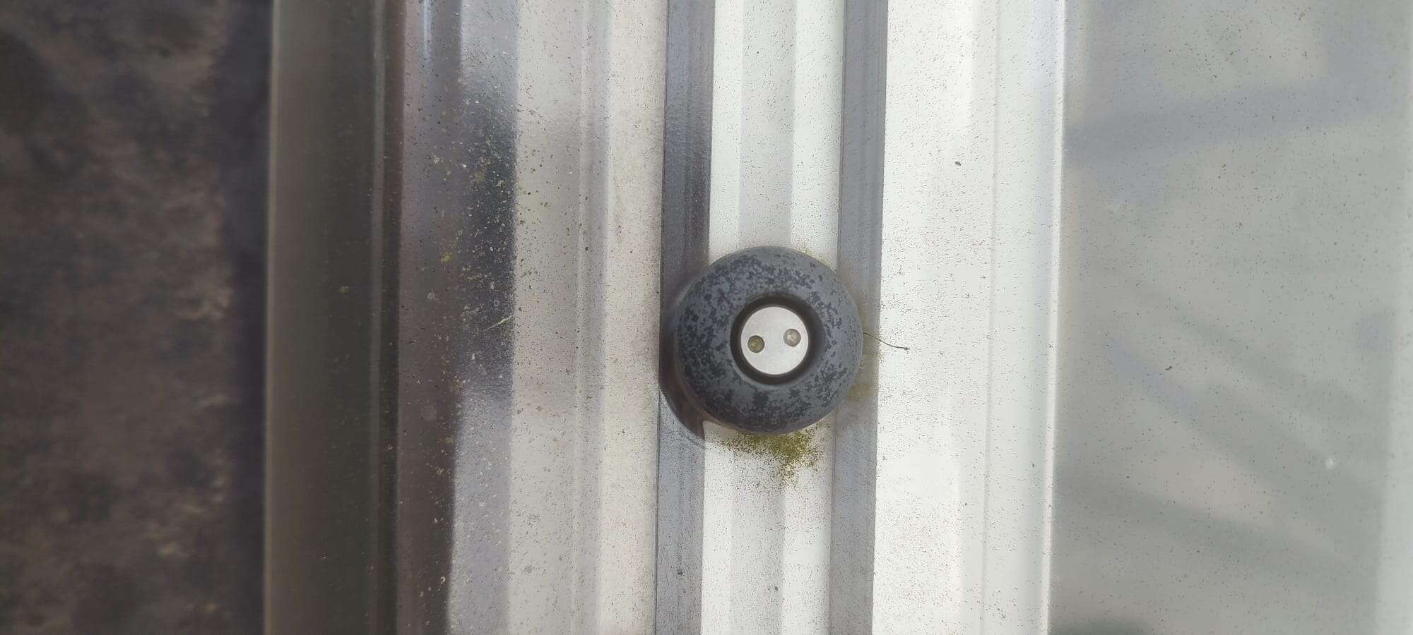

My folk's extention has a couple of skylights. I'm looking to remove them as part of a bigger job but they're held down with a number of these fixings.
Any idea what tool is needed to undo them?
I'd say the holes are 10mm apart at most and approx 3mm across
Posted : 12/04/2026 11:28 am

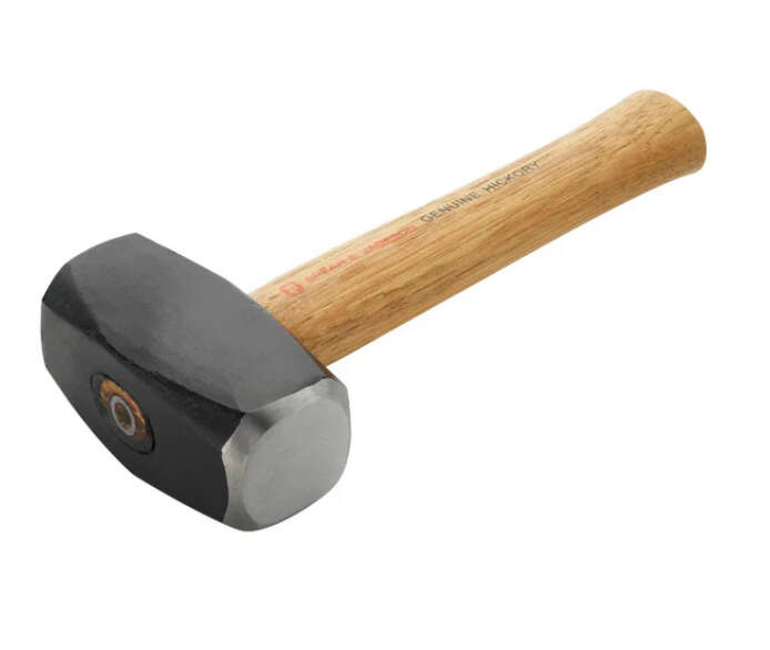

Posts: 5427
Posted : 12/04/2026 11:45 am
TedC, Drac, thepurist and 2 people reacted

Posts: 13637
Snake eye/pig nose/Two-pin security screw bits.
Your tricky bit will be sizing the right ones but they are cheap

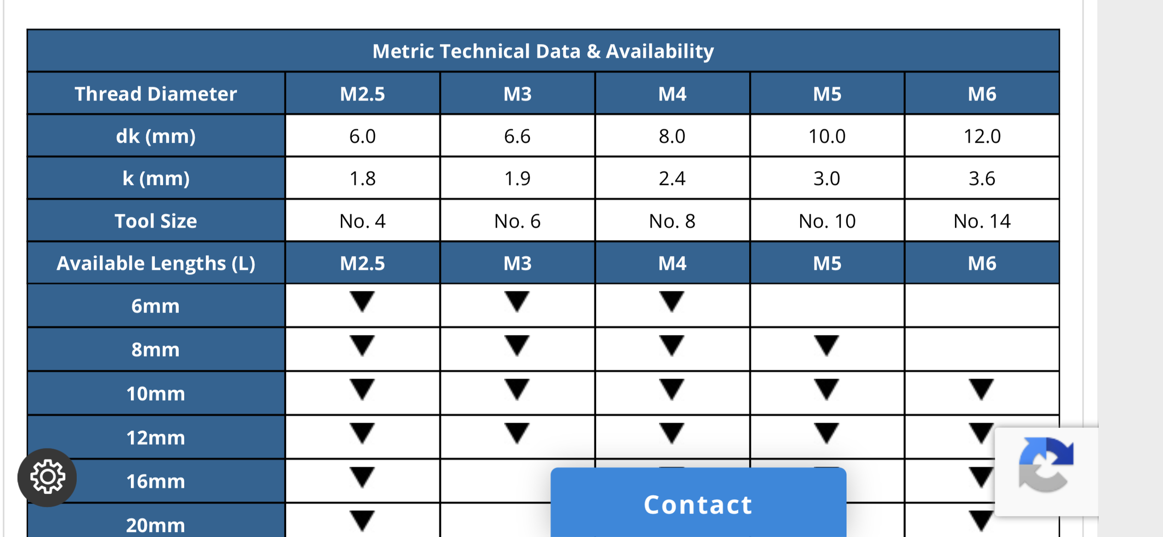

Posts: 486
The table below shows head size (dk) and corresponding tool size.
Posted : 12/04/2026 6:07 pm

Posts: 13637
Jesus there are some bodgers on here.
Thanks Temudgin. Thats a useful table.
