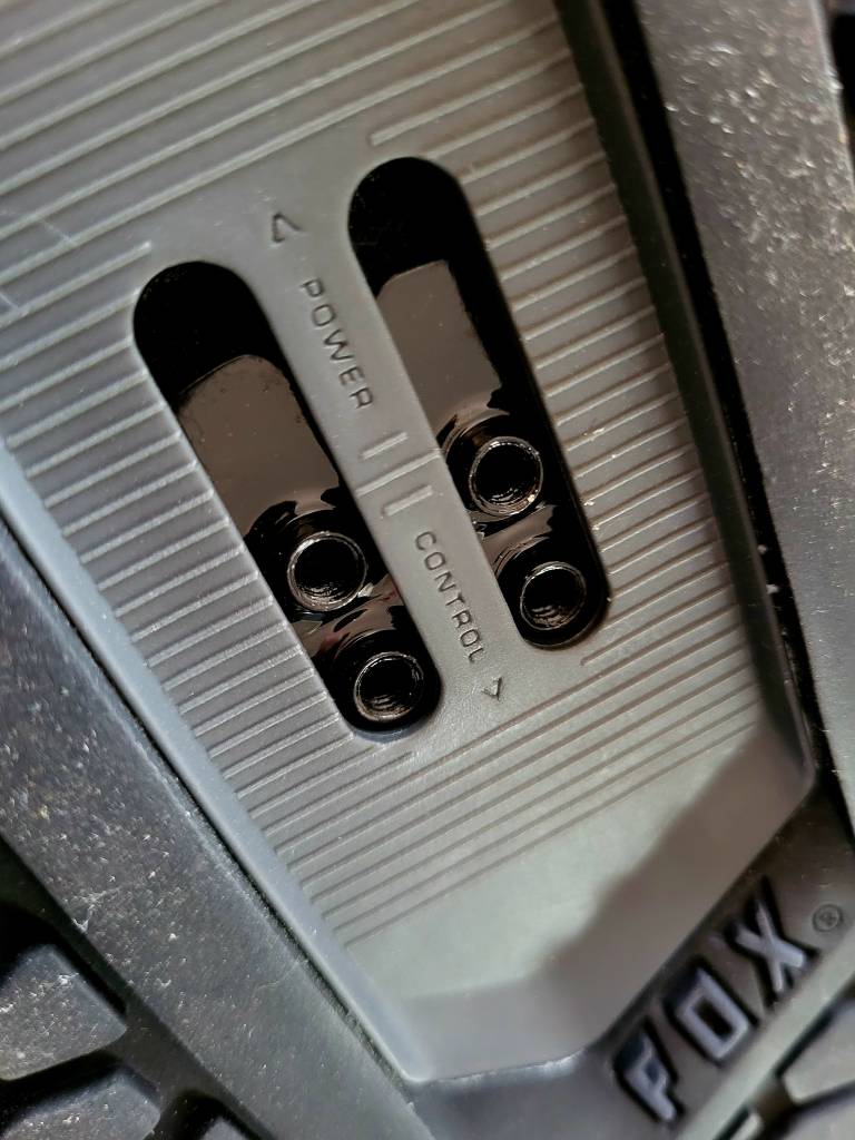

Fox spell it out on my shoes
They do look like the best option for shoes. I might have to wait until pay day to see how I feel about clipping in. It might pass before then!
