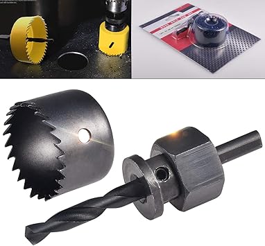

I would attack it with a hole saw and chisel first to clear some of the wood around it,see what you are dealing with..
hole saw
