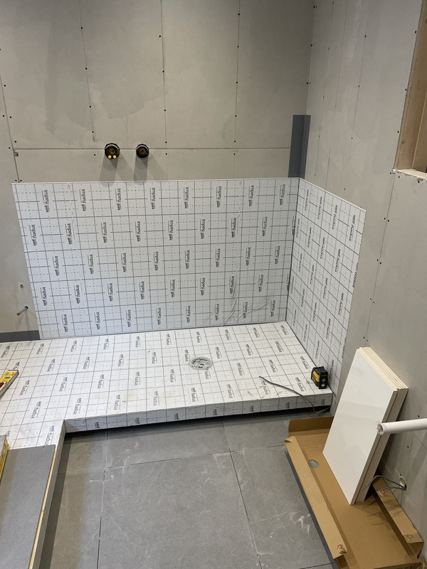

Looking at those black water marks on the tile adhesive and door frame, id say water has been getting under the tile anyway, but if the membrane is correctly installed I can’t see how it would get through the ceiling, so I’d suspect the gasket underneath the trap or a bad joint on the pipe work first I think.
Impey wet decks should be fixed to the top of joists (not cut into them) and nogged out to support edges, but I always over support them as I’ve seen a few flex enough to move tiles when stood on when following minimum specs.   I’ve probably fitted upwards of 50 of them, but have  flush mounted shower trays in my own house…

The impey system should have the deck fitted and then waterproof corners fitted, vertical and horizontal tape to all joints over lapping and then a membrane placed over everything with butyl sealant in the corners.  The membrane on the floor is (should be) sandwiched between the drain fittings before tiling.
I’m amazed your tiles even stuck let alone anything being water tight!
