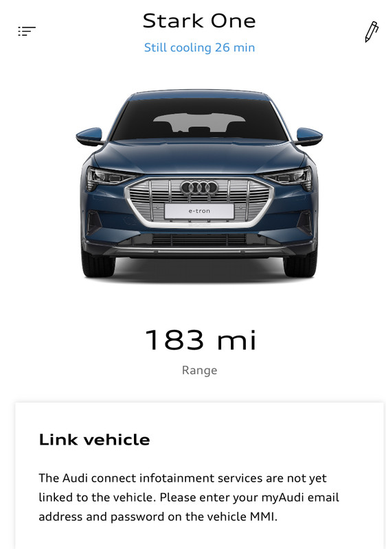

Posts: 50453
Loaded my E-Tron up and drove 268 miles to the west coast of Scotland on Thursday. Stopped at Sterling Park and Ride for some food a sleep as I’d been at work. An hour later on my way fully charged, it’s cost me a total of £0.
Posted : 31/07/2021 7:53 pm
Posts: 2875
If you mean my home town Stirling then you are braver man than I. With Chargeplacescotland network changing admin from BP Chargemessup to Swarco there were reports of the CYC app not working even though the official changeover date was 26th June so when we travelled up to Scotland on the 16th July I chickened out and took our diesel simply because we had to make a trip down the Mull of Kintyre and there are no non-Chargeplacescotland charger options there and of the Chargeplacescotland chargers only the in Lochgilphead one appeared to be in operation. Good luck with the rest of your trip as post change over Chargeplacescotland network appears to be a complete sh!tshow. Hopefully Swarco will get their act together soon. We stayed in the Premier Inn in Stirling for a couple of nights and I noticed the nice new fast chargers in the car park opposite on Forthside Way. Hopefully I can make use of them when I'm next up end of August.
Posted : 31/07/2021 10:55 pm
Posts: 50453
Oh I was nervous but you can just ring them tell them there’s an issue and they’ll activate it. I just used my CYC card.
Posted : 31/07/2021 11:08 pm
