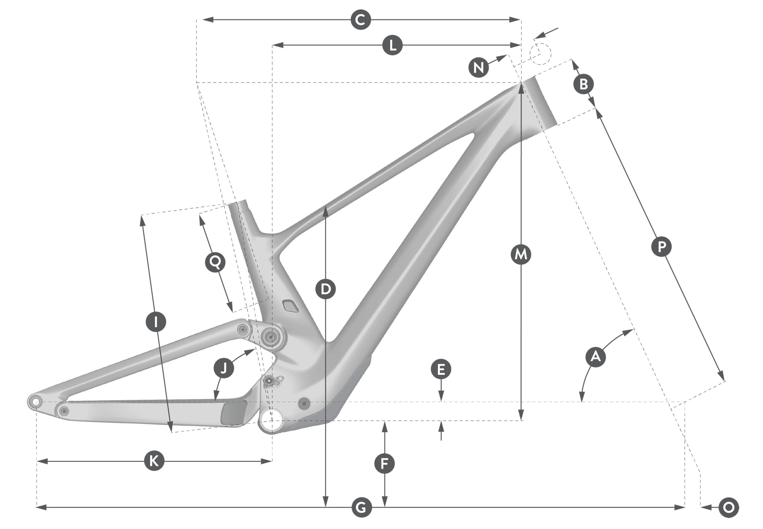

@eddd Any quoted teach figure is measured from the top of the headtube, so a tall headtube without a stack of spacers and/or tall bars accurately reflects the each figure achieved. If you need to move the bars up from a low headtube, you’re shortening the reach vs what’s quoted. Front centre is a combination of other additional metrics.
Posted : 23/02/2025 12:37 pm

There's no benefit to long headtubes beyond making them long enough that the headtube, steerer, spacers, stem and bar combination is adequately stiff.
Reach is reduced by raising the bars (whether by stem, spacers or bars as long as you keep the grips to steerer relationship constant) but if the frames reach is 20mm longer on a given size, then for a constant bar height the actual reach is still >20mm longer if there's any extra headtube at all.
Not on an XC bike they don't.
Only because slamming the stem and flat bars is fashionable.  A 250mm headtube would look equally fugly.  We'd all end up riding bikes like Emily Batty.
If you want a 'perfect' fitting bike with flat bars, flat stem, no spacers, it'd have to be a custom build for you otherwise geometry needs to be literally be the lowest common denominator so that the most people possible can then pick anything from a flat bar to +80mm rise.

Posted by: thisisnotaspoon
Correct, but the reduction in reach from fitting a higher rise bar is much less than the reduction from adding spacers under the stem. I'd much rather have a longer HT if it means I achieve/maintain my desired stack without faffing around with spacers (and losing reach) or very high rise bars. Doesn't mean all frame sizes need to have longer HTs but increased proportionality for XL frames would help IMO.

but the reduction in reach from fitting a higher rise bar is much less than the reduction from adding spacers under the stem”
Only if you accept the steering feel changing. You can’t raise the grips on any bike without reducing the reach - the stack and reach are firmly linked by the head angle.
Posted : 24/02/2025 12:19 pm
Posts: 41786
That is dependent on the shape of the bars though and how you rotate them.
In your example you're effectively lengthening the offset between the bars and the steerer tube (like running spacers + longer stem and flat bar).
For most people they would want to keep that constant, either by picking bars where the rise was added inline with the steerer rather than by bending them forwards, or by then running an even shorter stem,
You would, someone who likes a low front end wouldn't.  And the frame needs to fit both.
And you're not 'losing reach', as we've already agreed, if the grips are ~300mm above the fork crown on a Large, and the XL has 20mm longer reach, the bars are still 20mm further forward.
You only get less than the advertised reach increase if you do something nonsensical like compare two sizes with the same number of spacers and different HT lengths.  If you compare two sizes with the same steerer tube length (but the larger one has any extra HT at all) then the reach increase will always be MORE than the advertised value.
If you want a taller headtube and more reach than an XL, then the solution isn't to increase reach and stack but keep calling it XL, it's buy an XXL surely?
