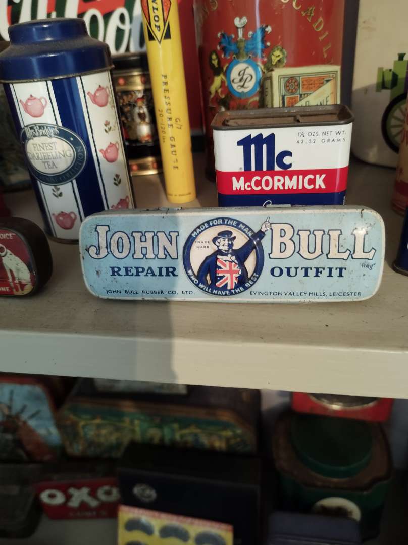

Talking of puncture repair kits.
Saw this in a cafe the other day.
Wander if the glue has dried up. IMG_20250504_133026951.jpgย

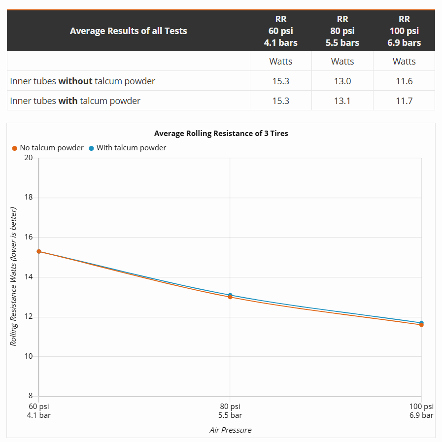

Checked my puncture repair kit that travels in my top tube bag. The constant rattling around has caused the little cube of chalk to rub against the sandpaper so now my tool kit is full of chalk dust and the cube of chalk has slowly rattled itself into a perfect little sphere. Extremely satisfying.
Talcum powder for tires and patches here also, although I read something (will try and find it) to suggest that allowing the tube to move about in the tire generates friction and heat which manifests as increased rolling resistance, and that you actually want the tube to move WITH the tire instead. Wonder if I've been doing it wrong all these years. Will have a chance to experiment this weekend I think as the new tubeless rim strip I need for the gravel bike hasn't arrived, will need to brave the Hawthornes with tubes instead.
Edit: found it. Absolutely definitive proof, I've been losing 0.1W per wheel all these years! 😭ย
