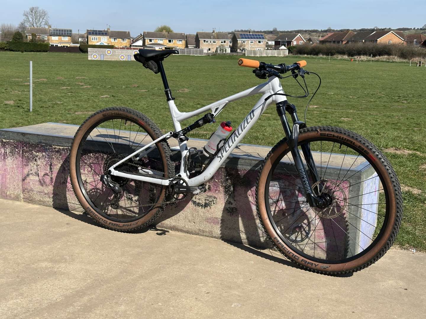

Just a little update:
-I fitted M6100 calipers (with sintered pads), straight swap with the M410 calipers. Quite happy with the set - thanks cerrado-tu-ruido.
-Turns out the rear M410 caliper was leaking - appears to be where the two halves join together, though I'm not sure (brake hose wasn't exactly torqued from factory, which I realised upon removing it).
-Something to note: I think there are two versions of the SM-RT64 Centre Lock rotors? 'Deore' comes with an internally splined lock ring (for QR type wheels?); 'SLX' has the externally splined lock ring? Regardless, it's all sorted.
-Bars for my S size bike were 770mm (as I measured them) - trimmed them to 740 after experimenting with holding the bars in different positions.
Getting there slowly but surely. 👍

Good to get out on a shiny new bike - even better after a hiatus. I had 13 years off MTB riding - missed out on a lot of fun (and cleaning!).
The X-Fusion "lockout" on my bike firms up the rear (a little) for pedalling... it's not a lockout really. To avoid the faff of using the lockout (rightly or wrongly), I've set my sag in the seated position - else I find it too soft even when descending out of the saddle (bottomed out once or twice).
I really think I could do with a volume spacer though, but parts are like hen's teeth here in the UK -  little to no support. Also, the air can service has quite a short interval IIRC - 25 hours? 🤷‍♂️
The dropper remote works very well on mine - it's easier to use than my gear lever. Maybe check the routing, etc.
Bike's done 400 miles so far (200 this year after the rebuild). Nothing's broken or worn out apart from the headset at 200 miles. 👍

 momo
Posts: 2114
Got a little carried away over the weekend, spotted some lightly used Fox 34 performance elite with the grip 2 damper - 130mm travel, same spec as fitted to the chisel evo, going cheap on eBay. Fitted them yesterday, didn’t think about them not fitting with the front wheel though, so I’ve had to swap the wheels between my bikes for now.
Also have a pair of used 170mm XTR cranks on the way. Currently weighing in at 14.04kg with my fairly chunky wheels fitted.

 Oms
Posts: 264
Posted by: momo
Very posh. What stopped the stock front wheel being fitted (was it the brakes?).
Keen to know what a 130mm fork offers over a 120 in real life. Is it really just 10mm, or is there more to it (ie such forks are tuned for different riding).
Posted : 12/04/2025 8:01 am
Posts: 8236
34s should in theory be stiffer and probably lighter. The oem wheel maybe did not fit as it may come with torque caps.
Posted : 12/04/2025 2:40 pm
 momo
Posts: 2114
As nixie said, stock front wheel came with torque caps to suit the rock shox forks.
Posted : 12/04/2025 7:16 pm
