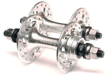

Hubs - the on-one large flange trackhubs (£15 each end) are good value for money and build up well. The rear comes in 120mm OLN.
These are flip flop hubs, both sides having lockring threads as well. You can screw a normal SS freewheel on. I run mine at 49:18 at the moment, 49:16 fixed sometimes. Look for ACS Claw, shimano freewheel or if you have thee money for the best, Whites Industries freewheel (c.£70ish)

I wasn't sure if the On-one hubs were fixed only or not.
I'll get some of them then and build them up on some cheap rims 🙂
Posted : 19/10/2009 11:04 am
Posts: 12
They are. You just need to buy one of the freewheels recommended by Stoner.
Posted : 19/10/2009 11:08 am
Posts: 36
to be fixed means it has to have an EXTRA set of threads (for the lockring), whereas to be free only needs the one set of threads (that are also used with a fixed sprocket)
see closely on here and you can see the two different thread diameters - the first takes a sprocket OR a freewheel, the second takes a lockring to hold a sprocket on, whereas its not necc for a freewheel
Posted : 19/10/2009 11:15 am
