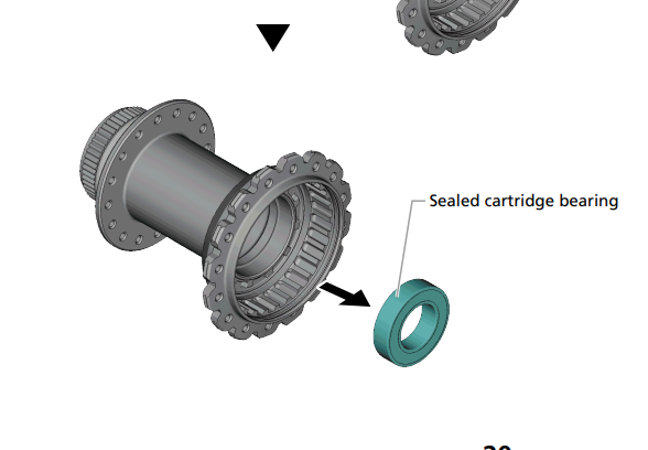

Posts: 1262
If you have the sealed bearing Shimano hub. Bin it! Complete pile of junk:
The teeth (in the hub) are softer than the pawls. It can only end one way 😥. To be fair Shimano may have addressed the problem on newer versions.
