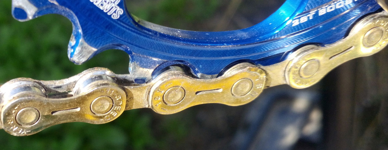

chain
chain after 850 miles of Surrey Mountains. Had a steel front sprox for most of the time. Just added the blue bling one to the new frame.. About 6 weeks on Puto & then the rest using candle wax home brew,
