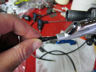

Blimey they were a piece of wee-wee to install 🙂
Took pics, in case anyone needs them for the confidence booster. Suspect everyone will have sorted it by now though (excuse is, we've been decorating the house!)
Start by removing the brake pads and putting the yellow spacer block in the calliper in their place.
mark hose lengths (measure twice, cut once...). I used a small piece of tape.
unscrew 8mm shroud nut
gently (but firmly!) pull hose free (older brakes needed a little squeeze of the lever to get this to come out, these didn't)
cut hose to length with very sharp knife (or cable cutters) - some fluid will spill from the cut end, so have something ready soak it.
The straighter and cleaner the cut the better as less likely to leak..
using the supplied plastic clamp thingies, hold hose in a vice - [i]make sure the shroud nut and cover are down the caliper end of the hose[/i]
Olive should be 4mm from the end (although these seem to be a loose fit, so it's not crucial)
Tap in the insert until flush
push the hose into the (other) lever. Push firmly while doing up the shroud nut.
A small amout of fuid may leak out. Tighten nut with the 8mm spanner.
Give the lever a couple of squeezes to check all is still firm.
If you're careful and don't shake the hose around too much, no fluid will be lose so you won't need to bleed.
Do the other hose. Replace pads. Fit to bike. Ride. Check for leaks 🙂

 Xar
Mine arrived this afternoon, no cup or bowl just he yellow arm band thing (but what do you want for free).
Shortened the rear hose following DezB's instructions had a bit of a faff as i haven't got a vice to help with the insert but other than that straight forwared and it works fine.
Went for a quick spin and they feel fine need to get out and give them a proper run.
Posted : 30/08/2011 5:30 pm
I put the yellow thing into a mole wrench, placed the edge of the yellow thing on a table, then tapped. Worked fine.
Posted : 30/08/2011 5:55 pm
 Xar
Sad thing is i was using a set of mole grips as i couldn't find a 8mm spanner, doh. Just held it and went for brute force and ignorance, took several minutes but it worked. 😳
Posted : 30/08/2011 6:00 pm
Thanks for that dez, made it nice and simple.

Do you definitely need this funnel thing for bleeding? Bit of a pain in the arse if you do, CRC don't have them in for 2 weeks.
Posted : 30/08/2011 10:04 pm

Done! Hoses chopped and swapped easily following the above instructions. Initial thoughts are very positive on a quick lap of the village. Modulation of Hope with the power of Elixirs works for me!

[i]Do you definitely need this funnel thing for bleeding?[/i]
I think you could do it the 'old fashioned' way without the funnel. ie. remove the reservoir cover completely and top up the reservoir. The funnel just appears to be a way to stop fluid spilling anywhere.
Had a quick go this morning - the bleed screw is a 2.5mm allen screw and the funnel screws into there - catches the fluid as you push it through with the syringe from the calliper end.
