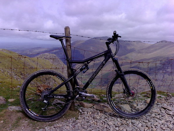

Tosh - ok, my frame is carbon, but still weighs in at 5.5lbs. Nothing is super bling - mostly XT, with Hope Tech M4 stoppers. The only area I've really gone to town with is the Roval wheels @ 1590g. You could lose half a pound off the brakes and probably almost as much off the huge Fire FR front tyre. Get rid of the tubes and chuck a set of carbon bars on and I reckon you'd be in the mid 26's. Oh, it's a large too.
No spending £4k for me. By some selective shopping and buying last years frame/forks etc it's cost me £2700. As said earlier though - even the Alu one's come in under 30lb. Just interested to see how many more out there did.
BTW - I weighed mine on the bathroom scales and it showed around 27lb w/o pedals and on digital fishing scales with CB Mallets attached 28lb, so I'm pretty sure it's around there somewhere.
And finally - for those saying why make a 6" bike this light? This bike is like my '06 Enduro on speed. The old bike descended superbly, but half of the time it felt like I was riding through mud - this one feels just as sprightly as my HT.
I reckon this is 32-33lbs, maybe I could remove a lb by taking off the chain device. The pedals and brakes are dead light, the build kit (thomson) pretty light. Talas 36s are about 5lbs right? and a DHX5, well I could replace it with the rp3 to loose a couple of hundred g's? Other than that I can't see much potential for weight reduction to below 30lbs without getting silly light XC tyres.
You may well get these bikes under 30lbs, with light tyres and wheels I bet you are all mincing around like you should be on a 80mm hardtail!
'koff - the only thing making me mince at the moment, is these Godforsaken clipless pedals I felt the need to try. Foolish me
Mmm, looking at your original photo I note that the travel indicator on the forks has moved less than 1/3rd of the travel available. Definitely indicating mincing until at least that point in the ride 😉
