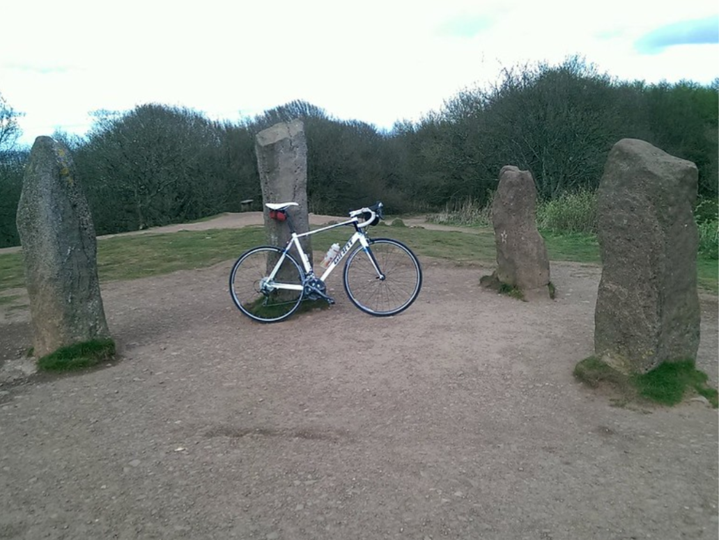

Posts: 24459
 Screenshot_20260510-220315.png Before 8 got my first gravel bike I used to ride my giant TCR with 25mm tyres and rim brakes off road. Only on dry towpaths and smooth bridleways though.
Didn't even consider trying to make it comfortable, just used to batter on. I was a lot younger then though
