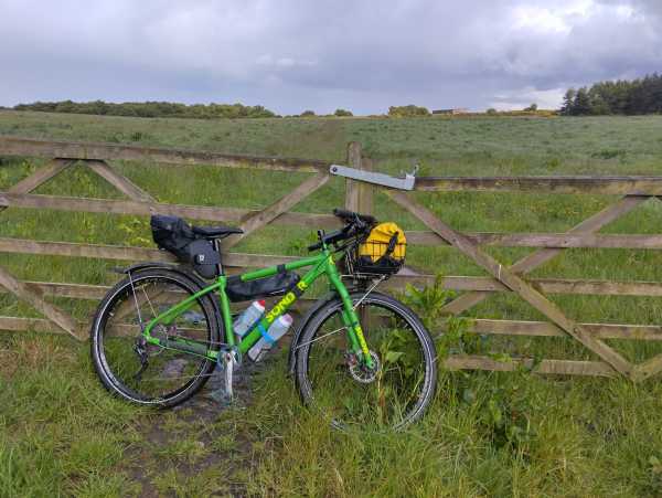

I've got a bottle cage there on my bike. Just a cheap bog standard one made from aluminium wire.
I use a large Elite bottle with a cap cover and a voile strap to hold it in place. It's worked fine although I usually decant the contents into the other easier to access bottle for drinking on the move. The cap keeps the mud and sheep poo off well. Not had the bottle jump out yet. Done a fair few rides with it last year including Traws Eryri so don't see it being a problem on a road bike.
https://www.elite-it.com/en/water-bottles/sport/jet-plus
IMG_20250608_155832_HDR.jpgPS not just used for touring but whenever I need 2 bottles as I can't fit 2 bottles and a frame bag in.
