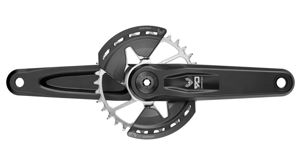

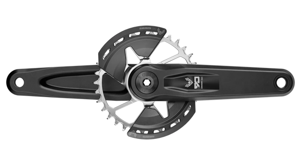

Posts: 1444
The bash there looks to bolt to the chainring, so if you hit the bash then you risk bending your chainring. I would buy or look into the transmission cranks with the bashguard although I don't know how they mount either
Posted : 18/05/2026 8:49 am
 a11y
Posts: 4094
Posted by: Stevelol
The bash guard bits - it's two separate parts - bolt through from the rear of the chainring using a kind of shaped washer that fills gaps in the chainring (hard to describe) . Seem fairly robust to me, although I removed them before fitting these as I wanted to use an upper chain guide instead. One of the few reasonable priced cranksets in shorter lengths too...
https://www.sram.com/en/service/models/fc-90-a1
