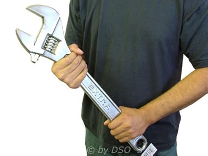

24" adjustable & you wont need an extra lever
cheater bars were barred from our workshop for a reason.

24″ adjustable & you wont need an extra lever
Generally agree, however if it has been massively overtightened/corroded many people will struggle to remove with a 24" adjustable.

Generally agree, however if it has been massively overtightened/corroded many people will struggle to remove with a 24″ adjustable.
because they cant lift it ?
ours was "elephant" brand - which i thought was quite apt !
ours was “elephant” brand – which i thought was quite apt !
lol
2 other guys were trying to get it off, one was lifted off the ground.
I have a 36" wrench for special occasions.
