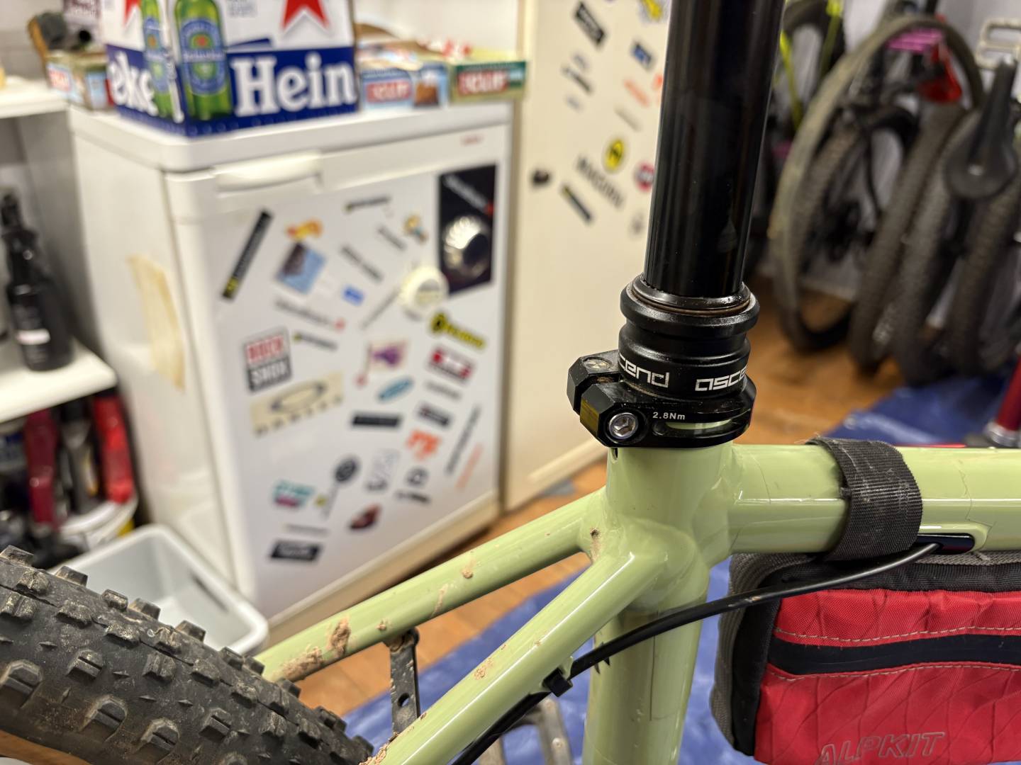

So decided to take my Nukeproof Digger on the Marches/Castles route. It has a dropper fitted (100mm) that's slammed into the seat tube.
IMG_7122.jpeg This is important as it further limits my options which appear to be:
Tailfin AeroPack: https://www.tailfin.cc/aeropack/?v=7885444af42e - the seat clamp needs 30mm of seat-tube or dropper tube. I don't have anything. So it'd need some kind of adaptor to protect the post (Wolftooth do one- £25) or a cheap 70mm dropper Merlin are doing for £45. Also would need the 'extender' to get the pack away from the seat post so the saddle will clear it when dropped.
It's a pretty expensive solution already without the additional gubbins.
Alpkit Koala: https://alpkit.com/products/koala which I have and have used. It has the frame that bolts into the top of the seatpost and it works well. But the strap at the front wraps around the top of that post so no chance to drop it. Short of fitting a non dropper post (which again I have) can't see any solution
I really don't want to lose the dropper as the Digger is good fun off road with the dropper and there looks to be some good sections of singletrack on the route. But I'm not wild about spending a ton of cash on something that I may not use that many times.
Any other solutions out there I've missed. Ta.

Oh I did wonder if the tailfin clamp *might* fit the post collar as its about 28mm but does have a big groove in it. My feeling is it would be too much of a compromise in terms of the clamp being stable enough especially with the extender.

I use a Wolftooth Valais for this exact problem, can use it with the majority of seatpacks and it only cost around £25
Posted : 19/02/2025 1:52 pm
Posts: 28540
+1 Wolftooth valais. I use it with a Revelate Terrapin 8L, and it costs me about 25mm of drop height. However, you have even less post showing than me, so you might get tyre rub unless you restrict it further.

Thanks again- in no particular order
- the Apidura I looked at for the last trip. It would work but it's another bag I don't really want to buy
- Panniers/Camelbak not an option I'm looking at currently. Done some MTB trips with really heavy packs and it's not a lot of fun in my experience. Panniers I have no knowledge of and are not a rabbit hole I'm currently keen to explore!
- Big frame bag means I need to find somewhere for 2xwater bottles. There are ways of doing it (and the digger does have some mounts that might work) but I have a alpkit bag that fits great and gives me WB space so want to start with that. Would prefer most of weight to go into seat pack.
- Wolftooth solution now I've looked at it may well work. I thought my AK bag had two seat post straps but it just has one I can move to the top. Sure I'd be down to 70mm of drop but I'd take that for £25! I think I'll be okay with the drop to tyre as they are only 650bs 🙂 Did a quick mock up with unloaded bag and it looks "within acceptable tolerance' 🙂

Topeak DP mount. Works absolutely fine on both my droppers with a Revelate seat pack. Better on my rigid bike than FS as there's no risk of rear suspension compressing and buzzing the pack

Having had a think, not totally against a rack - one of those that @bornonaboat posted.
@Benp1 - did the DP mount fit without mods to your non TP seatpack? I'm looking at it and wondering how well it would mesh with my Alpkit Koala..

Zero mods. My Revelate seatpack works great with it (I have the harness one but my viscacha would also have been fine). I used to use pipe insulation or a bit of cloth, this works better as you can drop the saddle more

I didn't have time to experiment last night, but Sunday weather looks like a shed day so will report back on the seat post options. take the point about weight, not going to be carrying too much, and maybe it'll be the reason I need to stop adding stuff just in case.
If I can't make it work, I might try the topeak adaptor, after that it's going to be a lightweight rack and some straps!

So it kind of works. I'd need the wolf tooth attachment to on the post to attach the strap. But
- get about 60mm of drop before it hits the tyre (but prob use 650B wheels so get a bit more)
- The seat pack is going to rub against the post. No obvious way of standing it off
- Post is powerful enough to pull pack back up but that was just some random clothes in there, so prob be heavier on the tour.
I think for £15, I'm going to try the ToPeak stand off mount and see if I can jury rig it onto my Alpkit pack. Gone off the idea of panniers for the moment.
Plan C, or maybe about Z now is my Bro has both a Mason Bokah and a Spesh Diverge he's happy to lend me with some custom made bags. But I feel I've invested enough time in this to want to find a solution..

I think that the bag will rub the hell out of your stanchion and frame

 Alex
Posts: 7501
@fat-boy-fat that has the rail installed. Problem is it needs the front strap to stop it swinging so that's always going to bring the pack to the seatpost/frame.
@martinhutch - yup. No way I'm going with the current setup. Really think simplest solution is just to temporarily replace the dropper with a fixed seat post. Hopefully without have to remove the dropper outer cable
Posted : 02/03/2025 7:34 am
Posts: 43522
Posted by: Alex

 Alex
Posts: 7501
Posted by: intheborders
One thing though I'm blessed with that Alex is not are long legs
Very true, I'm mostly a dwarf from the hips down 😉
I do have a small 4l waist pack. That could come into the 'packing equation'. Still I was also considering carrying my HipLock.
Anyway my mechanically minded mate is back from hols, so we're going to do the mech hack. He might have some ideas on retaining the dropper but it's probably just going to either not drop or get swapped.

 Alex
Posts: 7501
Thought I'd come back to this thread if anyone else searches for similar.
After further dithering, I ended up with a discounted backloader 10L from ToPeak to go with their dropper solution. It works well, I get all the drop without hitting the tyre, it comes back all the way most of the time, sometimes needs a bit of help for last 20mm. It's a sealed cart in those droppers tho so no chance of adding any air.
In use, I can't feel it really, I'm not loading it with any heavy stuff nor filling it completely. Plenty of space even when I added some extra stuff to test it on a ride.  Hopefully the mount won't break or the seatpost explode. I'll let you know in 10 days or so time!
Oh I couldn't get my old Alpkit bag to fit, the straps are a bit flimsy and without the exo-rail it's a bit of a whale out back. Might have been a solution but when I saw the TP pack on offer, I decided that was a SIGN 🙂

 Alex
Posts: 7501
Final update: dropper adaptor worked well. The ToPeak bag is excellent as well. Just pulling out the dry bag at the end of the day was a nice solution.
My riding pal had a Tailfin setup on his FS MTB and it was brilliant. If I was doing a lot of these trips, I'd definitely invest in one of those tho. Just faff free and totally solid. I didn't get much noticeable "waft" off the seat pack but it does move about especially on lumpy descents.
The dropper survived just fine. Did need some help to get the last 20mm, but didn't get any worse during the 4 days.
