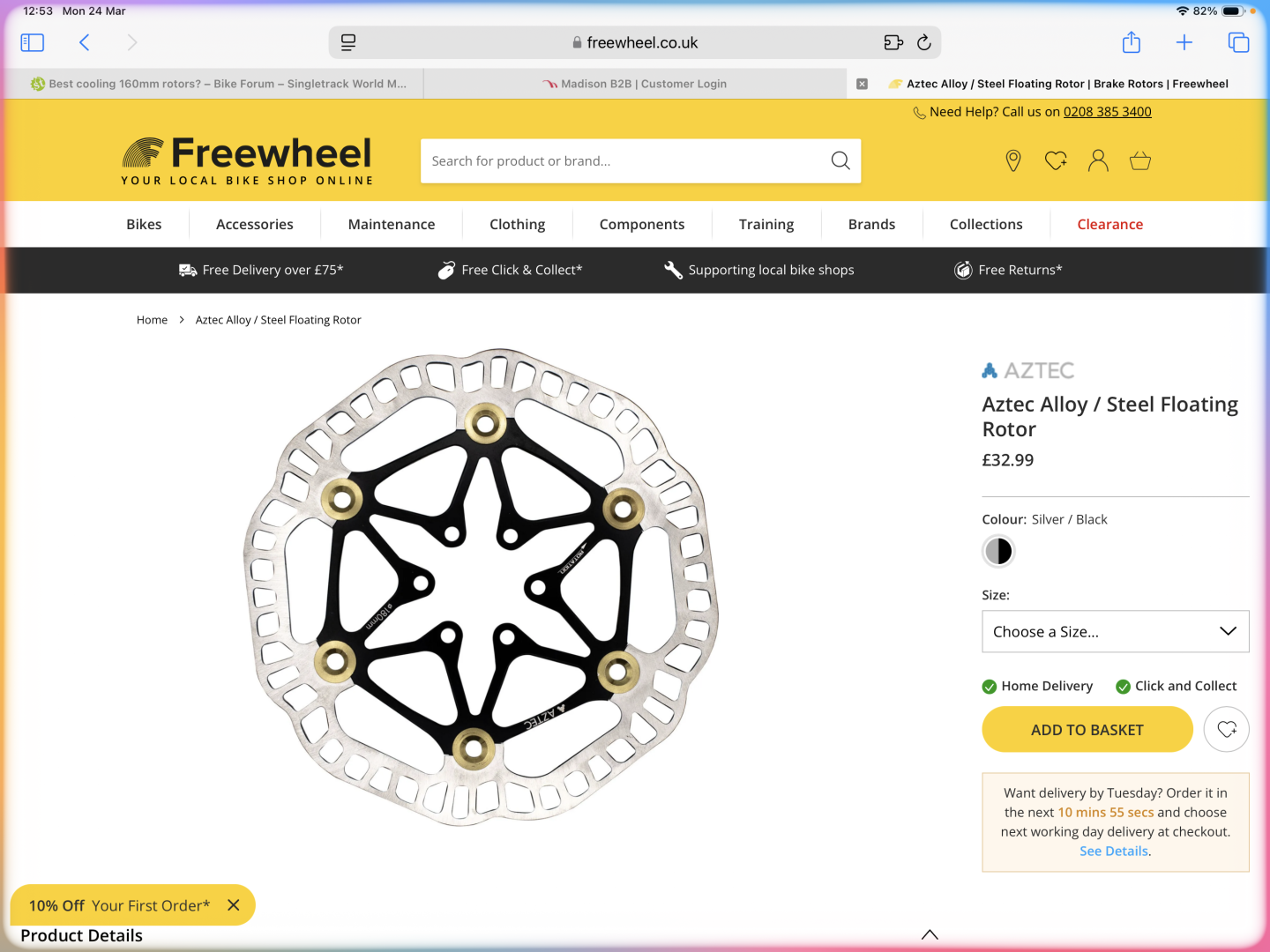

Posts: 2776
Apart from readily available Shimano XT, Aztec do a floating 160mm, six bolt that I have used and are excellent quality and resistant to warping. Available from the importers, Madison, via www.freewheel.co.uk
Posted : 24/03/2025 12:52 pm
Posts: 2776
