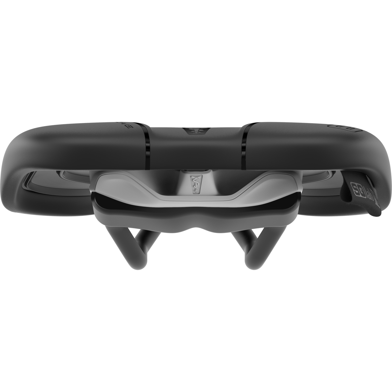

If you've tried numerous traditional shaped saddles, but haven't tried a Selle SMP variant, try one. You're supported between the two peaks instead of a majority going through your sit bone points towards rear of saddle, the drop between the peaks is critical to individual, but typically ~11mm iirc.

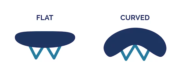

i'd add curvature to that, as seen from the back of the saddle, assuming that's not what you mean by scoop. i.e. this:

Nose width - too narrow and your sitbones aren't supported when you're on the rivet, too wide and it chafes. Trek Aeolus and Selle Italia Novus were a smidge too wide, Specialized Power just a bit too narrow, San Marco Aspide just right 👌
Seat width - too wide and it might chafe or push you up the nose too much, too narrow and you have too little support when sat upright. I've found most comfort going for a narrow Aspide recently as I don't use the widest part anyway it seems.
Taper from nose to seat (gradual V or abrupt T) - T shaped good for thigh clearance but not if you roll your pelvis when getting low over the bars and suddenly have no support for the sitbones. In an ideal world the taper of a saddle would match the narrowing of your sitbones which narrow in a gradual curve. Aspide seems most gradual apart from those SMP beak nosed ones.
Side-to-side curve - affects 'useable' width, a saddle can 'act' too narrow if it curves away too steeply despite measuring 'wide'. Lots of discomfort and chafing on longer days.
Front to back curve - needs to match curvature of your sitbones AND lumbar flexibility. I bend from the pelvis, not the spine, so need room for my sitbones to roll backwards and forwards. Something like an Aliante doesn't allow this.
