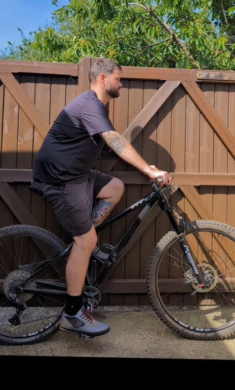

Took a side-on picture the other day and I look almost upright when seated, it's just not very comfortable or efficient feeling for me.
Show the pic.  I can't believe you're that short of leg that you need to compensate by slamming your bars on an MTB unless you're xc racing on a 29/32er.  I have an 29" inside leg and am on 80mm bars and have never been more comfortable on the bike.  I've adapted by simply bending my elbows a bit more.

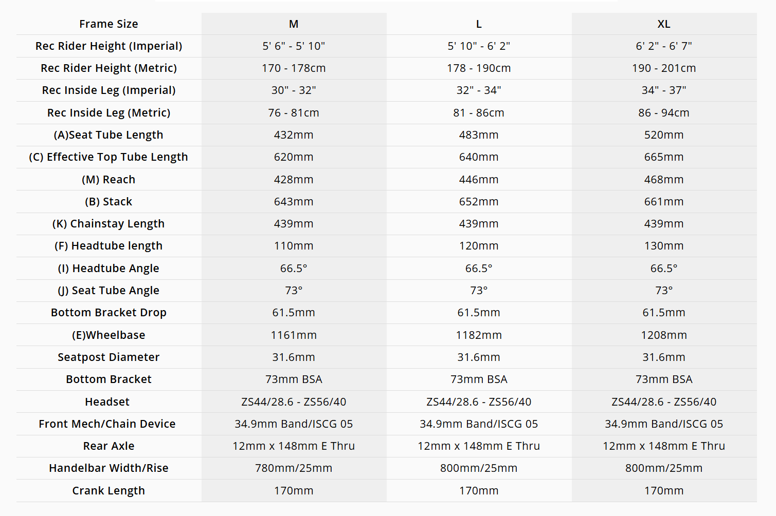

@Speeder here it is. Like I said I don't think I've ever had a MTB that fits me properly for pedalling so not really sure how I should be sat but it doesn't feel that comfortable to me, I feel like I want to be leant forward a bit more when pedalling. If I adapt my position I feel more hunched over which leads to a bad back. This is my first 29er which I jumped up to from 26" and even after 2 years it still feels very tall at the front to me. Looking at this the bike looks maybe a bit small/short in the TT for me, however with an ETT of 620mm it should be longer than more modern geo bikes recommended for my height n

Looks like a Sentier and if your ETT is 620, then guessing you're on a medium - the reach being 428, which is pretty short tbh. If you're having your saddle low too, you're also shortening your ETT. It does look a bit too small for you I'm afraid

Yeah it's a medium Sentier 29! I've always seen this as a parts donor bike tbh so I'm not against a new frame if I can find something suitable. I like the feel for descending/jumps etc but hate pedalling it around!
I'm recommended a medium on pretty much every bike for my height, which with steeper STAs seems to give an ETT of around 600mm on frames with around 450-460mm reach. Then when the lower saddle reduces the ETT, surely I'll be on a sub-600 ETT which would feel even more cramped? Or do I need to size up to a ML/large with longer reach?
I guess I could try shorter cranks (guessing these are 170 or 175) which will mean the seat needs raising a bit, and shorter is probably better for my hobbit legs anyway?

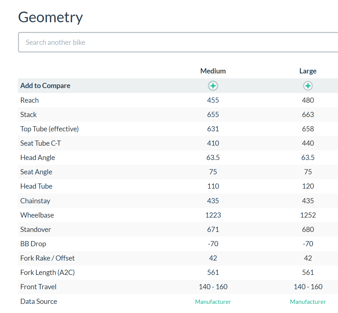

What suits me obviously has no bearing on what will suit you - I'm 5'11" and my HT is a large Ragley Big Al. It was a revelation when I first got on it as to how sorted it felt. I've obviously had much shorter bikes in the past, but this just feels right.
Compare the medium to yours above though and it does make the Vitus seem quite short in most areas - 62mm longer in the wheelbase, even though you have a slightly longer chainstay, so definitely indicates a short front end albeit the steeper head angle contributes to that somewhat

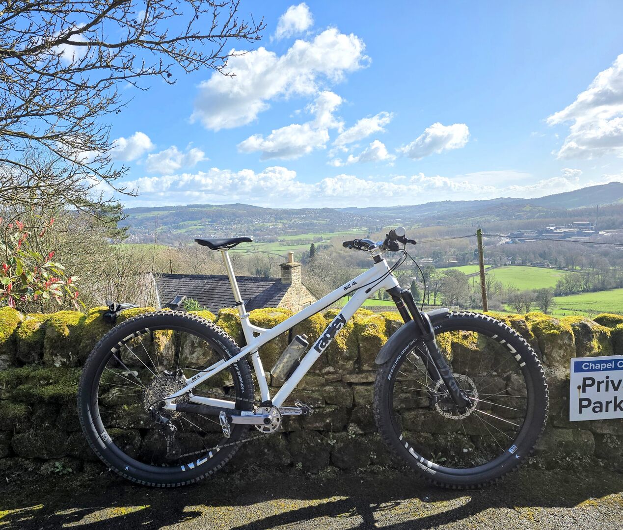

@_tom_ - my (large) Big Al

They do look good 🙂 wish I'd grabbed one or a Marley 290 in that CRC sale, though I did get this Vitus used for very cheap as a result of that sale! The medium Big Al looks like it could be pretty spot on for me. Looking out for that or a ML Bird Zero 29 on the used market.
