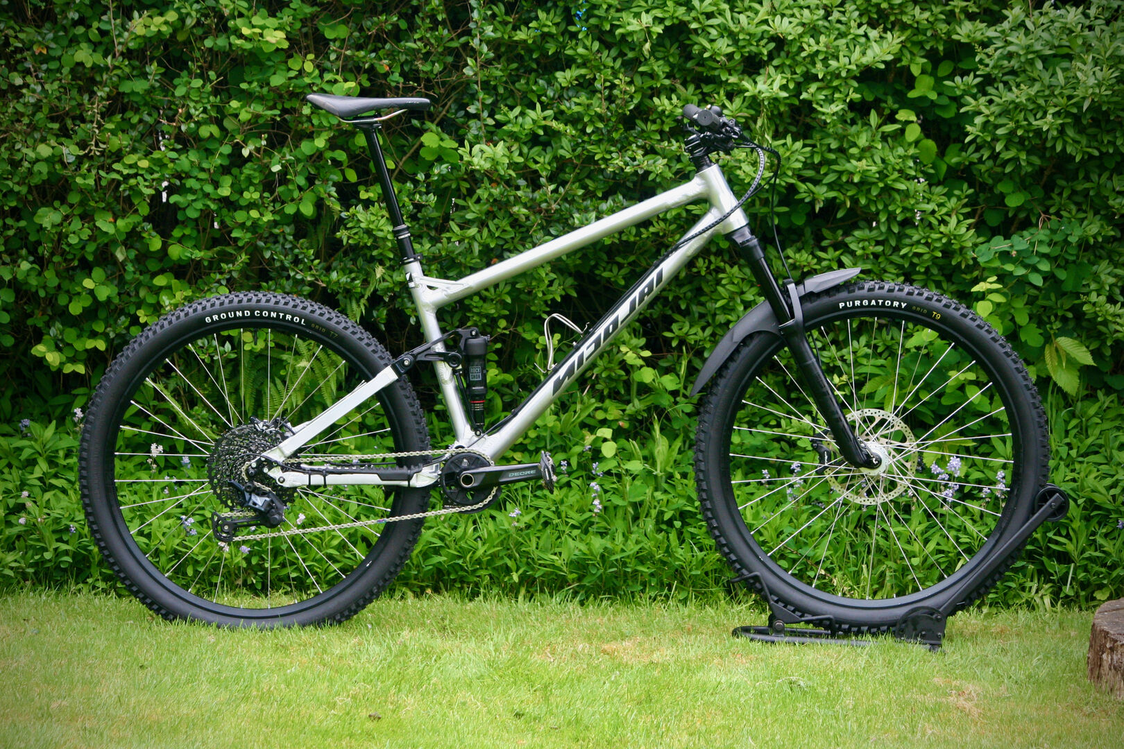

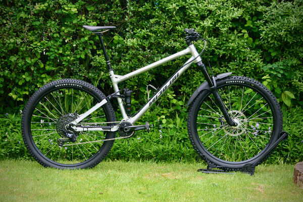

I'm a relative lightweight at 89kg and 6'1.5 (187cm) but being around Geometron forums I'm aware many bigger riders get on well with those. As an all-day rider a G1 might be overkill though. However, Nicolai do another short-travel bike with a similar robust build available in proper big sizes, e.g. Saturn 14 with 130mm rear. That's a great all-day bike IME. They also do a 'ST' version of the frame which IIRC has additional HT bracing.
I'm having issues with the Nicolai website but link here to STW article on my previous bike: https://singletrackworld.com/2024/07/readers-rides-allys-resurrected-nicolai-saturn-14/
215psi was enough in the rear shock for me so plenty of scope for heavier riders, and it's a decent stroke length for the amount of travel (@honourablegeorge makes a great point above). I've now replaced with a XXL Tallboy 5 which is flipping brilliant.
