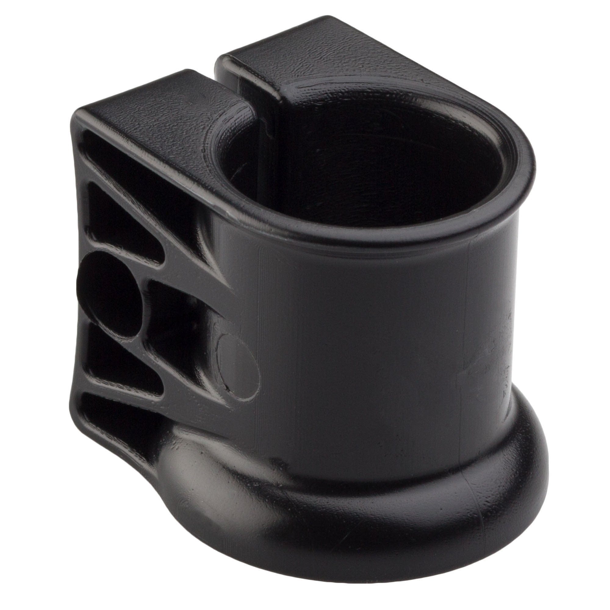

Reverb enduro collar
Pop one of these on and it will protect you post seal below it and you can mount your bag above with protection etc You can adjust how much drop you have got to stop bag fouling back wheel etc
seat post collar

Final solution, for anyone looking for similar. Managed to get a Topeak DP Mount from BikeInn (no UK stock), plus enduro collar. Worked really, really well. Seat pack was super stable (bit fiddly getting the strap right as it’s designed for a wider diameter; but good once sorted) and really liked having the option of a 1” or so drop. Haven’t checked for scratches but can’t see why there would be one as everything done up tightly against the post. Thanks all for the help - this has turned out ideal.
