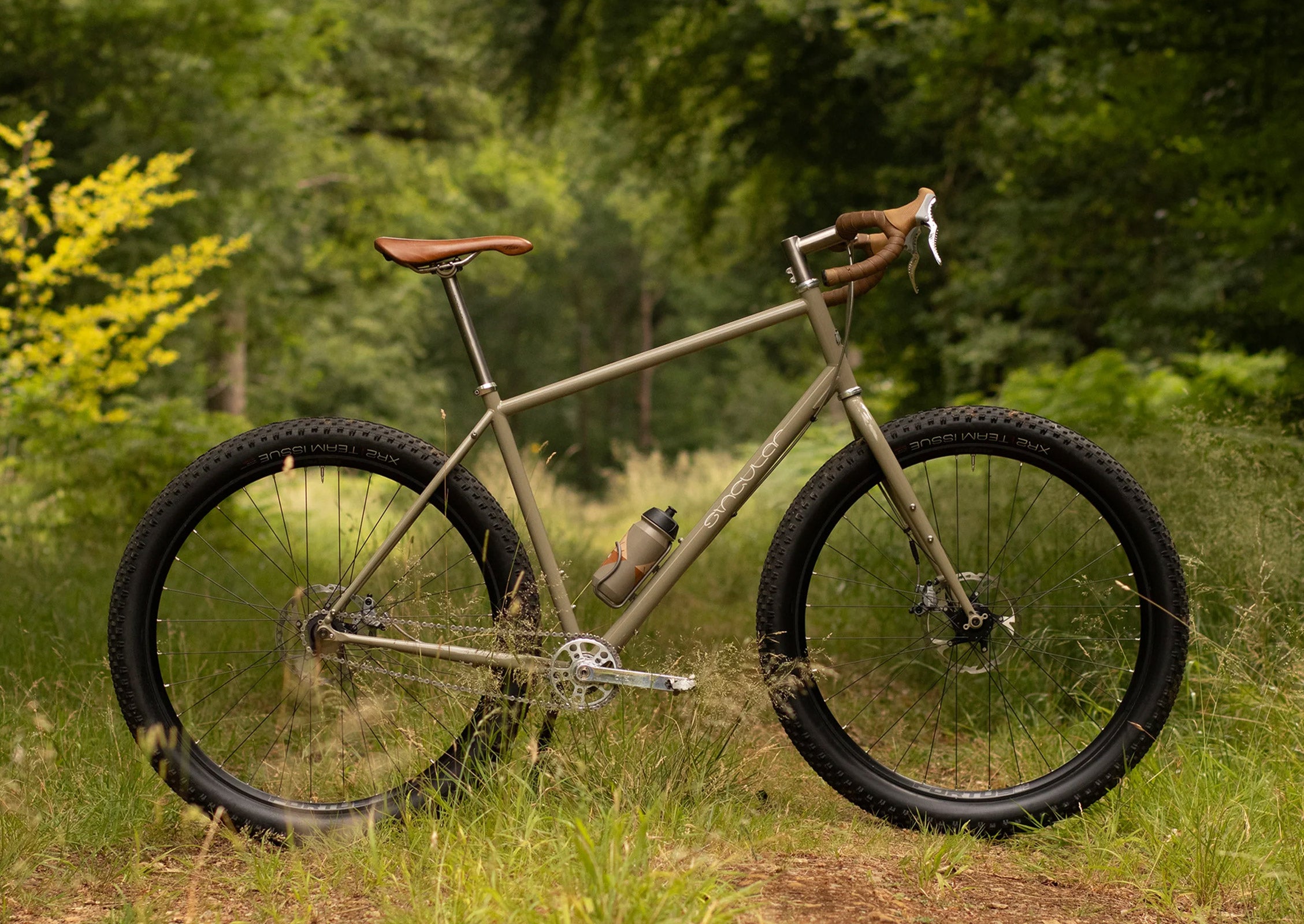

In "recommend what you own" fashion, I love my Brother Big Bro. Fills I think all of your criteria plus sliding dropouts for single speed if you like, not sure on max chainring but should be easy to check. I run a 34T and there's plenty of clearance.
Clearance for up to 29x3.0 I think, I've run 27.5 x 2.8 (pictured) and since swapped to 29 x 2.4 and it's been super comfy and a lot of fun on both. I probably wouldn't go with a 700x50 mainly because I think it would look odd, but also I think comfort would suffer, it probably does need a bit more tyre volume than something with a skinnier frameset and I think a Surly/Kona would be the same as the tubing on them all is a bit industrial compared to something like a Ritchey P-29 or a Singular.

*UPDATE*
NBD has come and gone with me finishing building my Cotic Cascade and managing a single, short shakedown ride before heading off for a family hol. I took it with me and made use of the SW Coast Path, managing many 1-2hr rides which away plus quite a few more on my usual local trails since getting back. It's all good!
No regrets moving to drop bars - I'd always shied away from them as a MTBer with a didgy lower back, but no issues. It helps I'm using Ritchey Beacon XLs: 52cm width across the hoods, 36deg flare and 670mm wide overall, with minimal 80mm drop (thanks to those earlier in this topic who suggested them). Only major expense was the GRX800 levers and mech: 1x11 plus a dropper controlled by the LH lever. All all just works.
Currently using everything else from my previous bike including eXotic fork for ease when building. Might try the Cotic fork to see for a higher stack height (I'm limited with the steerer length on the eXotic) although current position is comfy. I've got spare wheels with 29x2.4 Rekons to use sans mudguards although 700x50 with full guards is a useful setup at the moment.

Posts: 978
Looks good. It's the first Cascade I've seen with guards fitted and it looks much better than I'd have expected it to.
The Beacon XL bars are an odd one. I tried them on my Cascade after running it with flat bars for a long while then picking up a set of Sram Force AXS shifters for a bargain price. I was wholly expecting to hate the bars and already had someone lined up to buy the shifters and bars if I didn't get on with them. Turns out the bike's an absolute hoot with the wide flared drops. I'm running mine with a 100mm SID fork and it's brilliant. I'll try a Firestarter carbon fork one day when I find some for a good price.
Posted : 26/07/2023 2:25 pm
 a11y
Posts: 3906
Thanks. It'll mostly be wearing that setup with the full guards - also used for commuting and there's enough tame local trails that 700x50s are sufficient.
I know I could've stuck with flat bars and barends on the Cascade but sizing would've made it feel shorter in reach, even in XL, compared to what I'm used to. You're right in saying its a hoot with flared drops. At times - such as last night on a wilder descent over many roots - I wished I had bigger tyres for more comfort/grip, but at no time was I missing having a flat bar. Very grateful for the suggestions made to try out a wide flared drop bar.
Now trying not to start looking for a 100mm travel fork to use instead of the Cotic rigid fork...
