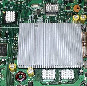

My original 2005 one started freezing playing Forza 3, so I opened it up and took the heatsink off and the thermal compound must have been applied by a luntatic using a footwide paintbrush, way too much of if and mostly in the wrong places. Cleaned it all off using some ArtiClean thermal compound remover/purifier and put some Artic MX-2 thermal compound on instead. Also changed the fans for some quieter but higher flow ones too, end of problem.

Screen getting all pixelated sounds like my old Xbox shortly before it started throwing up the 3 red lights.
I'd do as Russell96 said, worked for me for about 12 months before it went again. Time eventually caught up on it though and the periods between fixes got less and less.
I chucked it and bought a new one.
e2a: If you do end up fixing it yourself, replace the [url= ]old heatsink[/url] for the [url= ]newer version[/url] too...every little bit helps.

If you go ebay you can buy a DIY fix kit for about £6 - its pretty straightforward tbh.
http://www.ebay.co.uk/itm/ULTIMATE-Xbox-360-Repair-Kit-RROD-Red-Ring-Xclamp-/260770149111?pt=UK_VG_Replacement_Parts_Tools&hash=item3cb71cb2f7
