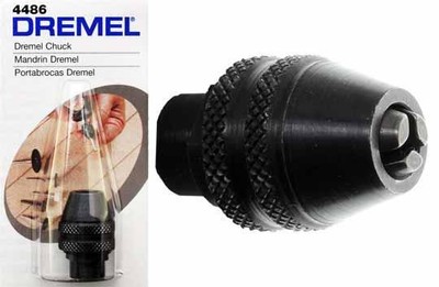

Bits are pretty much intercompatible, Dremel do a proper chuck but I buggered mine and it's locked after the first use. You can also get shims and such but they can be a bugger if they stick.

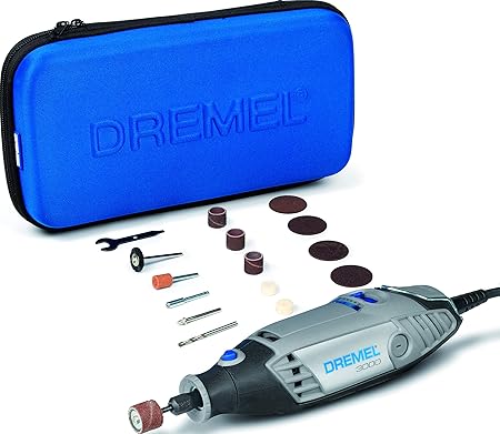

I use a Dremel 3000 .
It's pretty good. I have a little tool free chuck fitted which is handy for different sized bits without having to change the collet.
I just buy cheap bags of bits off Amazon or eBay. The chuck means they all fit. Came in really handy recently cutting away rusted bodywork on my van on difficult to reach places.

Corded 3000 the speed switches can be proper temperamental resulting in a fun game if will it spin and how fast will that be. Its a known issue but i can't be arsed fixing it.
Posted : 08/09/2020 7:24 pm
I use a 3000 with a snake and it is brilliant.

I also picked up a smaller chuck as the stock one didn't go small enough for my 0.8mm drill bits.
