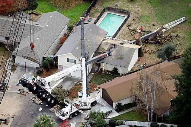

Have you thought about using a crane, like this one.....
Posted : 04/01/2012 10:35 am
that must have been a proper KYB* moment as that crane started to tip..
*Keich Yer Breeks
Posted : 04/01/2012 10:37 am
