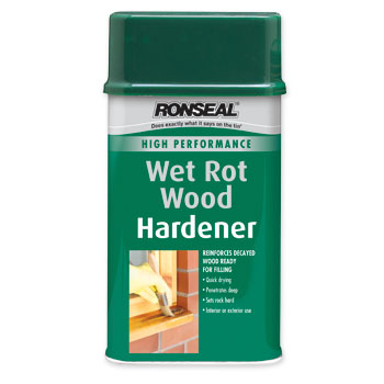

Does exactly what it says on the tin.
I've used it on some wood that had been wet for a while and started rotting. But if yours has just been damp then drying it out properly should pre-empt any problems.
Posted : 07/11/2011 10:25 am
But if yours has just been damp...
Difficult to tell just how wet it had become but 2.5 years of a constant leak every time we use the bathroom meant it will have got pretty wet I think - but I think I need to leave it a few days to see how quickly it starts to dry.
That looks a good suggestion though - thanks.
