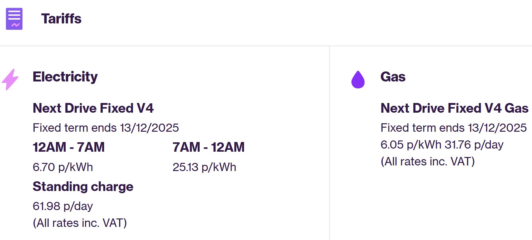

additionally - for those of us on flux.
do we see costs rising significantly when the pricecap rises - it usually follows suit.....
Anyone jumping to a fix and Standard outgoing at 15p ?
Posted : 27/02/2025 9:59 am
Posts: 1843
last flux pricing changed bumped the peak export rate up more than the other rates, if they maintain that import/export ratio for us with batteries, it shouldn't make a real world difference IMHO
Posted : 27/02/2025 10:10 am
Posts: 10940
Yep if you've got batteries then Flux would still make sense.

Posts: 13807
I moved from Ollie to eon, I'm on the V4 Next drive tariff. You don't need and EV and a charge batteries up at night at 6.7p. export at 16.5p during the sunny days.
Jan my electric was £27 feb was £16, just done my SEG claim and got £40 for export from Mid dec to 2nd march. I've not done any brown exporting yet just not sure about wear on battery
Their CS isn't great I managed to squeeze a £100+ out of them as a goodwill gesture. The app is poor but I can put up with all that for 6.7p in and 16.5p out
Posted : 05/03/2025 9:29 pm
Posts: 10629
That’s a good plan.  Are those values fixed?
Posted : 05/03/2025 10:06 pm
Posts: 13807
Yup fixed to 13/12/25
Think they are on V6 next drive now, no need for an EV. As long as you have panels and battery and be prepared for some hoop jumping to get SEG set up. Need a MCS doc, Schematic of solar set up, photo of smart meter and proof of address.  I ended up getting a new smart meter as EON couldn't connect yet I could see data on Hugo, Loop, Bright etc
Anyone wanting a referral link just ask 😀
Posted : 05/03/2025 10:36 pm
Posts: 10629
That's a much better deal than Octopus Flux.  Flux is currently ~15p offpeak from 02:00-05:00 and export day rate of ~13p.  on an import of 10kWh/d and an export of 20kWh/day, this is around £80p better on the import and 60p better on the export.  That's a max delta of ~£40/ vs Octopus Flux on those numbers.  On an Annual basis, this would be £300 better off.  @bruneep - please send me a link.
