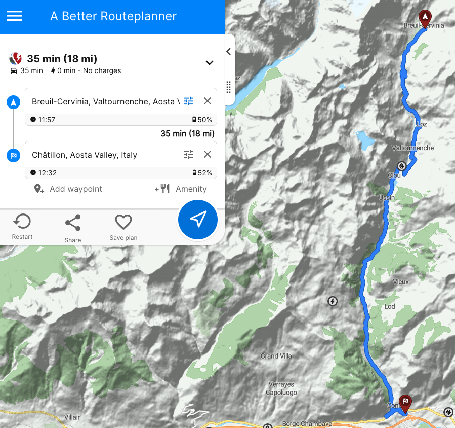

I would love to drive an ev down from Cervinia at 2000m down to Chatillon at 500m to see how much charge it would add. I guess there's some engineers or physicists on here that could do the maths?
Posted : 19/08/2023 11:46 am
Posts: 3399
@oldtennisshoes you might be able to get an idea using the ‘a better route planner’ app or website? https://abetterrouteplanner.com maybe you’ll get different results for different vehicle types too?
Posted : 19/08/2023 11:48 am

Posts: 5141
Good thinking @prettygreenparrot I'll have a look at that now.
Well that's disappointing
Posted : 19/08/2023 11:54 am
Posts: 91159
The potential energy available for that trip in a car + passengers of 1700kg is 25MJ which is about 7kWh. You won't get it all back because of charging efficiency losses but also air and rolling resistance. So work out how far the trip is, the efficiency you'd expect from your car if it were flat at a comparable average speed, and subtract that.
EDIT 18 miles, at say 40mph, probably only needs 4kWh to overcome friction. So you could probably gain 3kWh at most if you weren't using friction brakes into hairpins etc. Maybe 2 including generation and charging losses.
