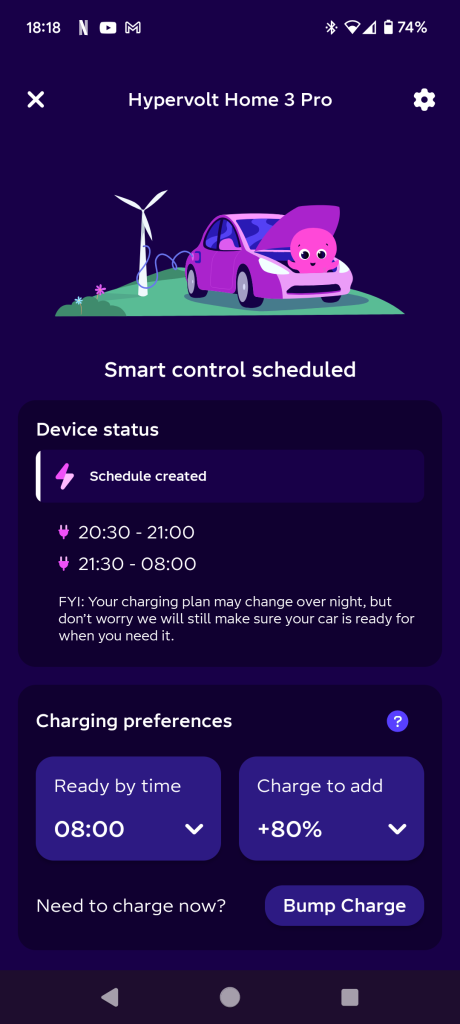

Can you folks help me get my head around charging schedules please. We have an iX3, the BMW app (which seems pretty good for scheduling charging), a Zappi, and Octopus intelligent tariff that sees the car plugged in in their app
I want to charge on the low tariff overnight, but I have seemingly no ability to influence the charging timings. Not sure where in the chain the problem is, but something is changing the charge timings in the BMW app and it will stop charging at 3 in the morning leaving us half full.  And sometimes it won't charge cos the app says our next departure is next Tuesday at 5.30AM, when we want it full tomorrow morning. Driving me a bit crazy.
What bit of the chain do i need to dump to be back in charge? Do i dump the Octopus app as that has one setting 23.30 - 07.00 and no ability to tweak. Do i need to do something on the Zappi? I don't want to stop using the BMW app as that one seems to give me the most flexibility.

What bit of the chain do i need to dump to be back in charge? Do i dump the Octopus app as that has one setting 23.30 – 07.00 and no ability to tweak. Do i need to do something on the Zappi?
Probably not much help, but in a Car-Ohme charger-Octopus setup the advice is to totally ignore car app and Octopus app and do it all via the Ohme app. If the Zappi can talk directly to Octopus, then I assume the same advice would hold.
I only have the basic Octopus (cheap 0030-0530) but as the installer said to me, you can only have one device controlling the charging. So my car is on 'dumb' mode - plug it in and as long as there are electrons being pushed into the wire it'll accept them, up until it's full. I just set the car to specify what full is - so usually 80% and only 90 or 100% occasionally when a need dictates (sl annoying, it keeps defaulting back to 50% as standard so I have to remember the set 80% each time. IDK why, Hyundai Bluelink if anyone has ideas)
So the charger (via an App, QUBEV) decides when to charge, which I've set to 0030 start and 5 hours duration, to match the Octopus cheap rate window.
At 0030, IF the car's plugged in and IF there's space for electrons, it starts sending them, until the 5 hours is up or it reaches 'full', whatever that is.
Sometimes I set it to run longer to top up more (but then pay the std rate instead) or I can put the charger on manual mode where as long as there's a car plugged in with space, it'll just send electrons.
For you - seems like you need to drop the BMW app down to dumb mode, and then let Intelligent Octopus decide when your Zappi can send electricity, based on when they've got spare rather than me deciding a fixed time. IDK exactly what you set, I think it's how much charge you want by when....but not sure. It sounds to me your problem may be that BMW and Octopus are fighting with conflicting demands?

Thanks theotherjonv - sounds like i might have to do that. have emailed Octopus to hear what they have to say - using the forum hoping someone had had the exact same issues. Will post back when i hear from them

susepicFull Member
Thanks theotherjonv – sounds like i might have to do that. have emailed Octopus to hear what they have to say – using the forum hoping someone had had the exact same issues. Will post back when i hear from them
My charging has been spot on with OIG, Hypervolt and an E-tron.
First I cleared all the charging schedules from car, so that the car only controls the max charge limit.
The Octopus App does all of the controlling, but it has to take over / integrate the Hypervolt during the Octopus app set up.
Will try and share a screenshot.
Posted : 24/01/2025 7:24 pm
Posts: 1089
Screenshot_20250124-181832
Posted : 24/01/2025 7:31 pm
