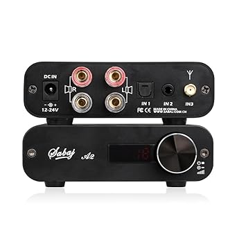

How about this:
https://www.amazon.co.uk/Q5-Coaxial-Optical-Digital-Amplifier-x/dp/B015ZHZG1K/ref=sr_1_2?s=electronics&ie=UTF8&qid=1495475302&sr=1-2&keywords=amplifier+with+optical+input
What you don't seem to realise is that your Mac has more than just a headphone socket, that socket doubles up as an optical out, so all you need is a little amp like the one above with optical in and a TOSLINK to connect the two.
It's how my Mac Mini is connected to my old Yamaha A/V amp, and I can control playback via the Remote app on my phone and pad.
Posted : 22/05/2017 5:54 pm
Posts: 5943
Yep, digital out from mac would be better. Headphone out is not the same as line level output. There is a gain stage involved, which means adding more distortion. You can obviously use it for the same purpose though.
This is about £60 on Amazon and you could use your Missons. Something similar without bluetooth would probably be about £45.
Posted : 22/05/2017 6:28 pm
