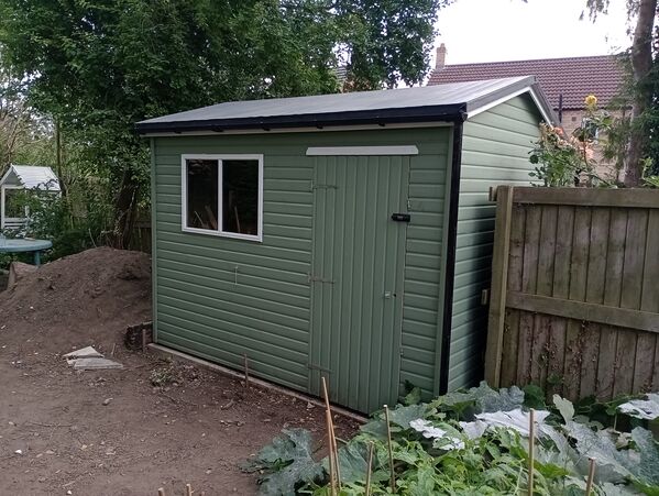

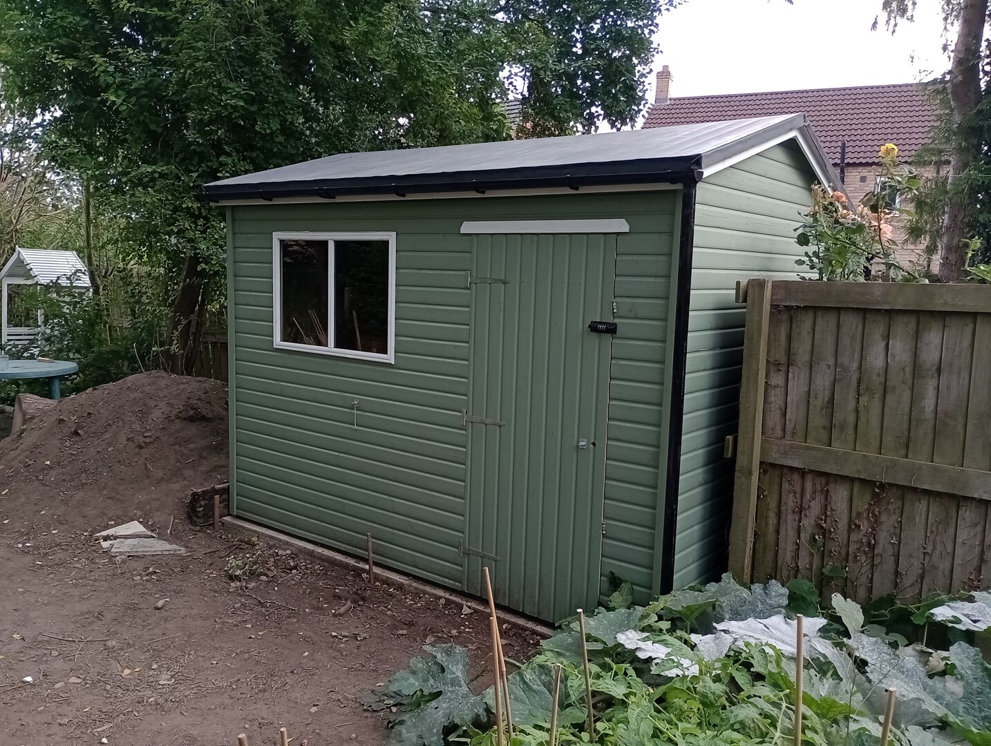

Generally I "improve" the detail on the standard ex-factory roof edge, adding fascia, barge boards and drip battens all round. On the pic below, I used the contact adhesive round the perimeter and onto the vertical edges. Trim rubber edge with a new Stanley blade against a extra spacer strip after gluing.
Not 100% successful tbh, a year or two later the rubber is peeling off a bit on the edges. I think stumping up for the proper edge trims is the way to go.
