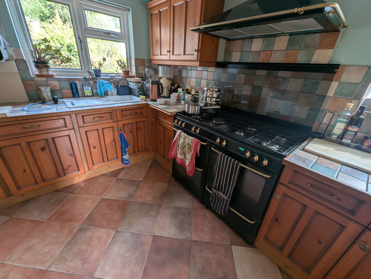

We have a kitchen with tiled worktop and all round high splashback with the same tiles, fitted cupboards, sockets, sink and whatnots. All in a sort of fake 80s cottage pine colour scheme.  The tiled worktop is a massive PITA as the grout stains, collects crumbs etc. and we want rid....
Bodge option - get someone to replace the worktop MDF with fresh MDF and large tiles (I do like the heatproof convenience) - will never match the wall tiles/floor/grout/fake pine etc.
Then we think hmmm - we could remove the hundreds of spashback tiles.  That'd likely need replaster.  Might be able to keep everything else in place.  Might then show up the mess of the cupboard doors.
Hmmm - could paint the doors - prob a pro spray job or buy new (standard 400/500 jobs). Ah but then XYZ other follow on issues that incrementally get to rip out the whole thing and start again.

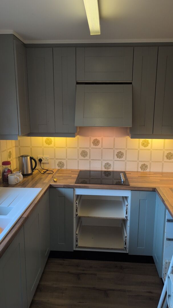

In a roughly similar situation with my wife's rental. We just decided to change the worktops & sink, refurb/paint the cupboard doors and put new flooring in.
All DIY, roughly £500 all in.
Still got the splashback to put in and handles to fit but otherwise about as good as we could have hoped for without spending ££££s

@theflyingox...  nice! How long did it take you approx?
Posted : 24/07/2026 11:23 am
Posts: 6351
Cheers. The whole place is a WIP having not been decorated since the early 90s as far as I can tell, so there's a whole lot more to do. The kitchen was a full week all in but I'm a total DIYer. My day job is sitting in a control room clicking buttons. Most of the work was the cupboard doors and could have been done much quicker if I had a paint sprayer (I now do, after this).
Worktop & new sink was a full day with worktop being the majority of that.
Floor took me ~4hrs to pull up the old tiles, flatten, then install the click-fit stuff.
Cupboard doors were the worst. It was a custom kitchen with odd door sizes otherwise I'd have just bought new and swapped. Used a router sled to flatten off ready for the shaker-style trim, then glued and clamped. Then wood filler in any gaps and sanding smooth. Then a coat of Zinsser shellac primer, then hand-painting with the sage green + sand + second coat. Was easy enough as the living room next door was empty so just set up some long tressles for it all to dry on, but it took A LONG time. If I'd had the airless sprayer I reckon I could have finished this bit in 1/10th the time.

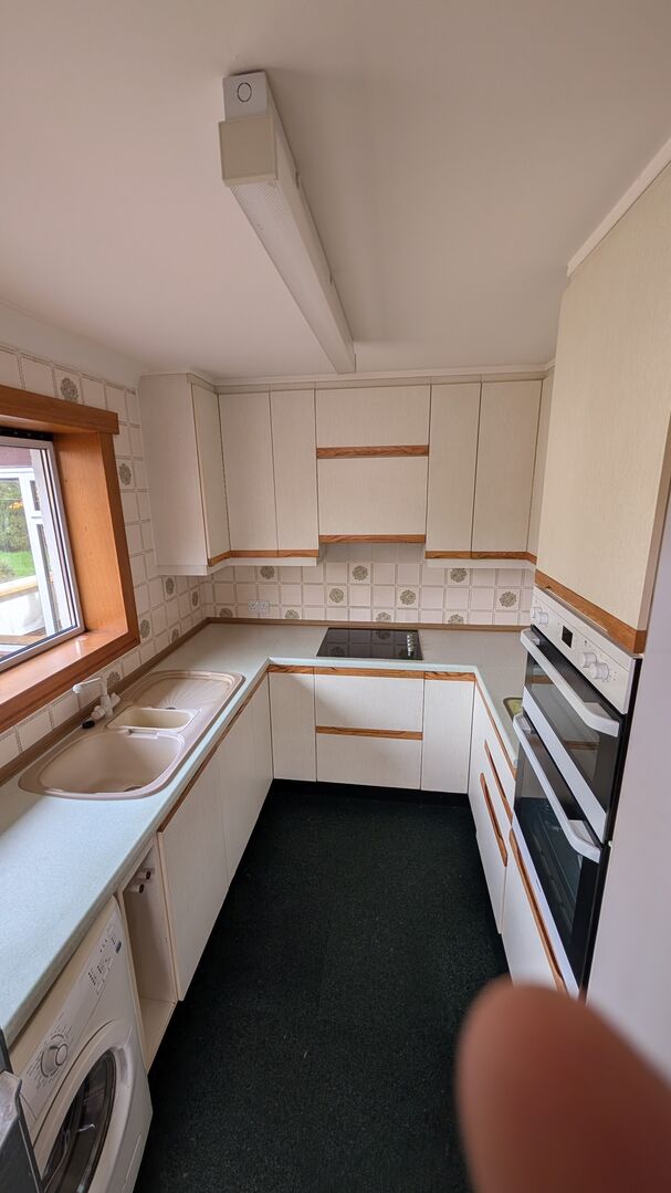

worktop tiles are the same as on the wall (and there many more than this wide-angle photo) - vaguely match the floor.  Sorry if you've run out of eye-bleach 🙂
