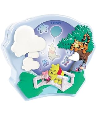

Just something that uses AA batteries but says rechargeable ones aren't recommended; why might this be? I don't like using disposable ones as wasteful IMO.
