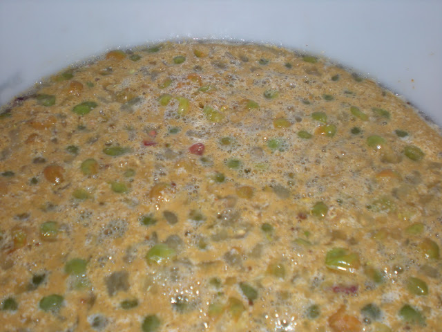

Well, for the benefit of anyone trying the same thing...
The natural yeast got going pretty quickly and was happily fizzing away, but the smell was not right at all. Possibly there was nothing wrong - I don't know - but not wanting to end up with 20 litres of chain degreaser I chucked in some campden tablets, which slowed it down a bit.
Some packets of yeast arrived on Tuesday, so I put one of those in. It now smells a lot more sensible. A sort of yeasty, slightly alcoholic grapey smell.
I chucked in some more grapes that I found on the vine, which is why it looks like alien brains.

Erm? You probably should have tried to squeeze all the juice out of the grapes before ferment. Leaving the juice to settle overnight would leave nice clear juice on top.
But anyway, it should be alright if a little bitter.
I'd go easy on the camped tablets at this stage as well, you could kill the yeast.
Posted : 22/09/2010 12:07 pm
Yes, most of the grapes did get the squeezing treatment. Just the few leftovers I found afterwards got chucked in skin, tannin and all.

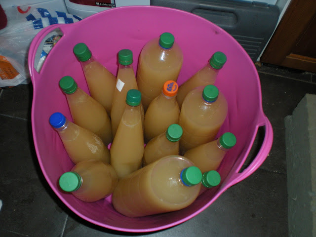

Bottled it.
Started at around 1080 (bit low I now realise) and finished a bit below 1020. So I guess it'll come out weak and sour, [s]just like ...[/s]
Anyway, it's still live. Amazing stuff is yeast. We'll see what it's like in a month or so.

Well, it's been bottled around a week. It should have carried on fermenting in the bottle.
Looks like the smaller 1L bottles were OK, but the larger, 2L ones (which were previously just ordinary coke bottles) were not up to tje job.
Tastes kind of OK actually, although a bit sludgy from being shaken up.
I'll just go and check on the taste again, just to make sure.
