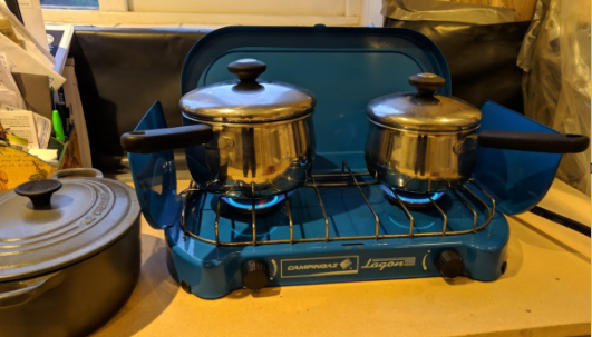

One of the biggest frustrations was the ability to cook a more substantial meal, plus lack of general internet access / WiFi calling as mobile network was down.
What are you thinking of cooking?!  You can do a lot with a twin burner camping stove.
For power you may just be better off with a generator perhaps?  [much longer run times]

I do have a double ring gas burner in my campervan which is in the garage - bit of a faff to get the van out to cook a meal like we had to on Sunday.

Just buy another if it's an issue.  If you want a battery or generator to power all/part of the house you'll need to jump through a few hoops - i.e. having a changeover switch installed that stops the battery/generator back feeding into the network and zapping the poor sod trying to reconnect you.  It's not insignificant.
