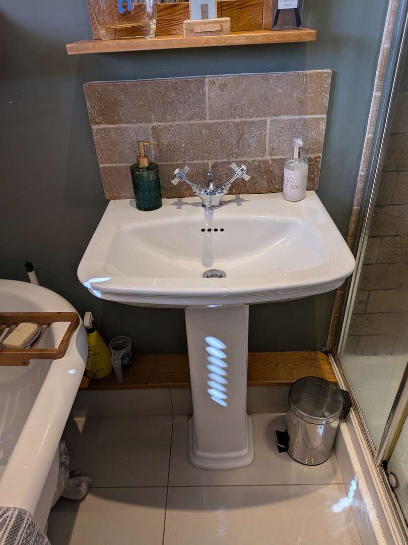

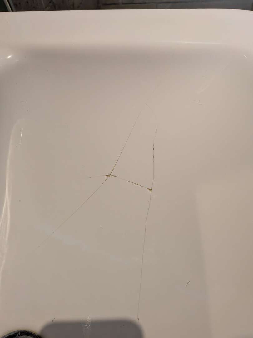

So I have a chip/crack in a bathroom sink. Son managed to knock the shower head out of the holder, as he tried to stop it snakeing around, he knocked a heavy glass ornament off a shelf and onto the sink 🙄
I've tried but can't get anyone local to do it. How much of a faff is it to DIY and what are the pitfalls? I'm generally OK with straightforward DIY stuff, but not done this before.
I'll probably replace the mixer tap whilst I'm at it, but I've done that before with no issues.
Can I just replace the basin or so I need to do the pedestal as well. I've no idea where it came from and there's no makers name on it so matching a basin with the pedestal might be tough.

If it was installed with inline taps in the tails, then it's relatively straightforward - shut off water supply at tails, remove old fittings, fix new one in place and reconnect the supply.
If it hasn't been connected with tails with taps, then I'd strongly recommend fitting them as part of the process; it's a little more faff, but if you can work on your own bike without wrecking stuff, you've probably got the basic level of savvy to do this job. I say this as someone for whom plumbing is the only DIY task that's had me close to tears of frustration!
If you have the luxury of a second loo in the house, that also helps reduce the time pressure to get the task completed.

The taps will be easy the issue will be the fact the tile splashback will never in a month of sundays be correct level for whatever you replace it with.

A more risk-free solution would be fixing the crack – there's stuff for it (linky).

You other issue might be the boxing in. That looks quite deep which might limit pedestal options. Its fine if the gap is a bit bigger. But its a pain is its smaller.

I've just had a look. I don't think that repair kit will work. The crack is worse than it looks in the picture. There is a quite noticeable level difference either side of the crack in places, which a filler isn't going to sort.

The repair stuff can be ok, but in my experience it will most likely still show.
You might be better off with a wall hung vanity unit and basin as you will be able to get it to fit under the tiles.
The chances of getting another pedestal and basin (they are individual to the basin so both need changing) that are the same height is slim.
You could also use a half pedestal as again you will be able to get the height right. Both options require a decent fixing in the wall though.

I would have thought there is a decent chance you will be able to get a sink the correct height - too high will work anyway.  They do tend to be a standard sort of height and actual fitting the sink is easy - waste pipe is probably the trickiest bit

Google image search suggests this is a Vitra Serenada washbasin - you might be able to find an exact replacement, thus saving the compatibility issues raised in the other comments ...
Oh you bloody legend! That does indeed look like the same one! Thanks!
