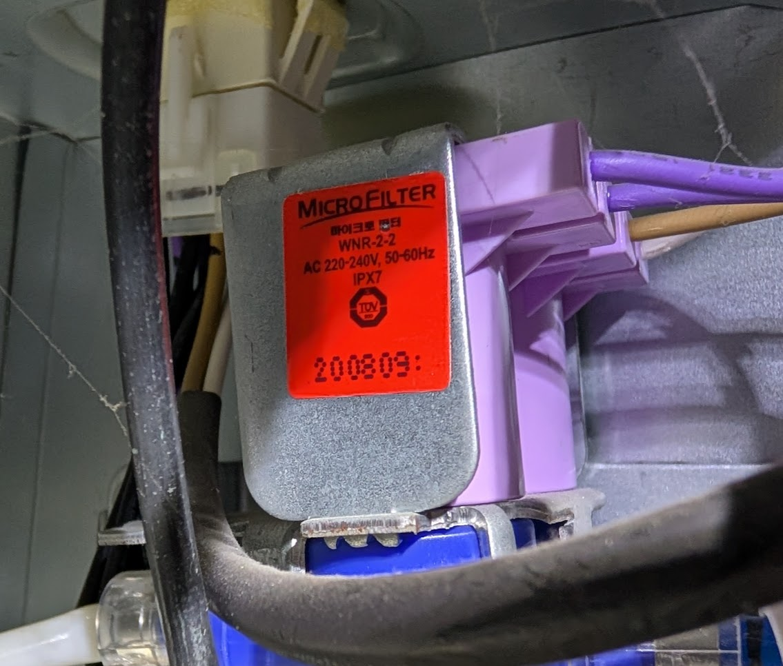

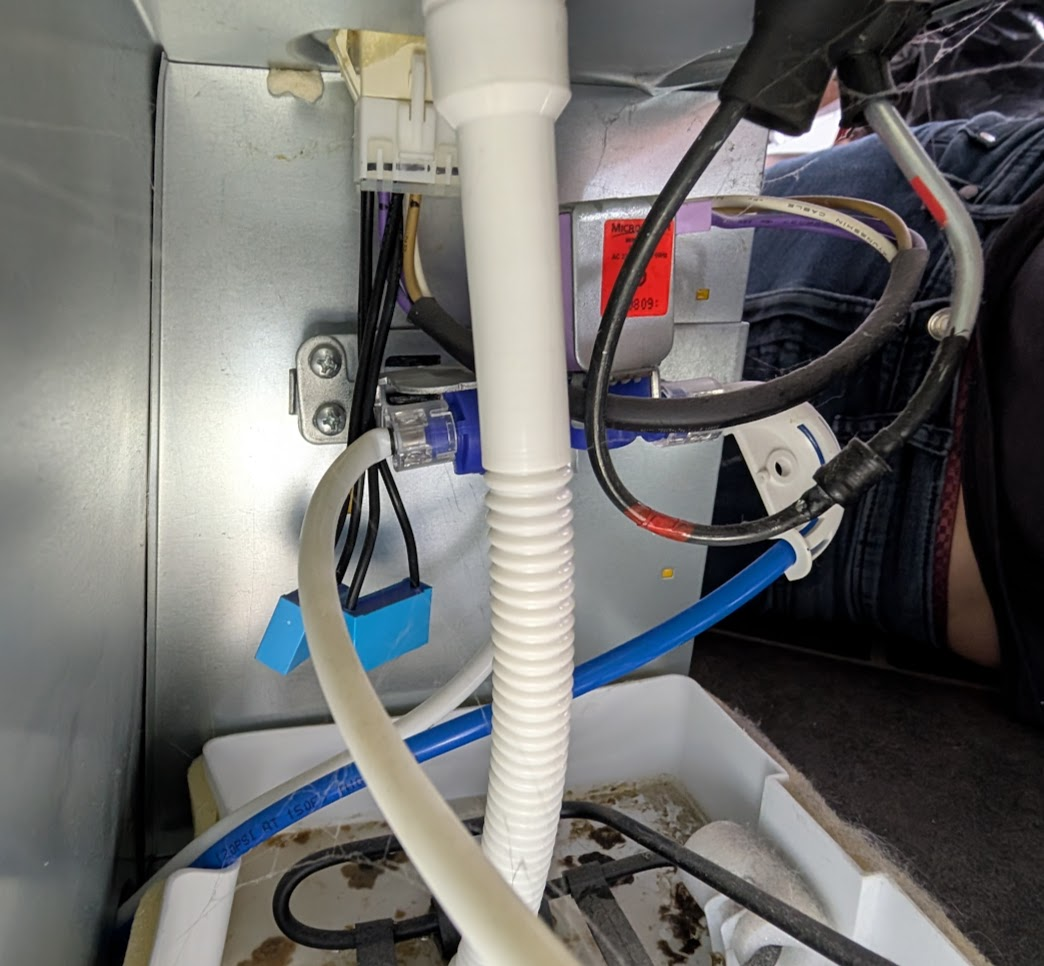

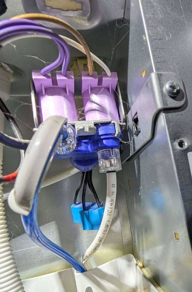

  • Around the back is a solenoid (pics 1-3 below), a white pipe goes into the back of it from the water caddy in the fridge. A blue pipe and another white pipe come out of it and head under the fridge. 4 wires go into it, 2 purple, a brown and a white.

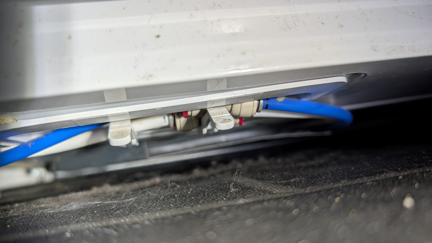

  • At the underside of the front I can see the other end of the blue and white pipes, they have couplers joining them to pipes which run up into the freezer door to the ice and water maker (pic 4).
I had suspected that the solenoid might be broken, however it's £75 quid for a replacement (I think that's the right one, but it doesn't list my freezer in the models) so I'd rather not buy one unless it's def the issue.
At the weekend I disconnected the couplers on the hoses underneath and swapped them over. I then waited for the ice maker to request water. When it did water poured out of the drinking water dispenser?!?!
I tried activating the drinking water dispenser while they were swapped, to see if it filled the ice-maker, but it didn't.
Does this suggest that there is a blockage in the ice-making hose (from the coupler to the door) rather than a solenoid issue? The hose in the door is pretty inaccessible, so I'm not sure how I could resolve that, if it is the issue.
