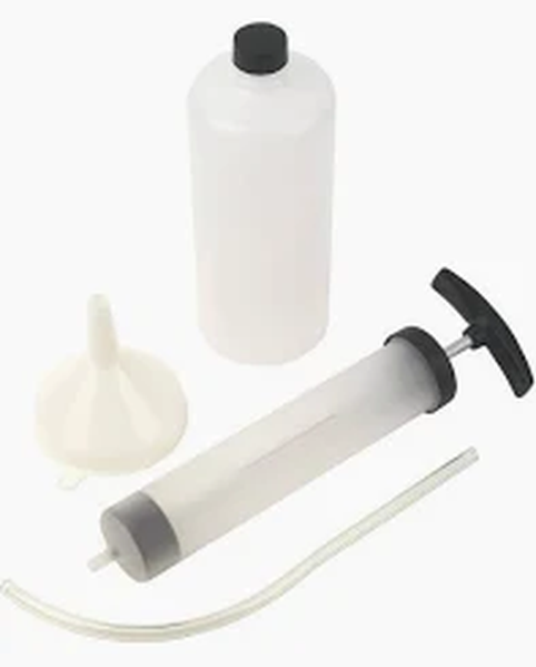

My son overfilled his 2007 Astra a few months ago and I bought a cheap kit from Screwfix for £13.99 to remove the excess. It worked ok once I figured out that I had to use a rag wrapped around the tube to get a better seal.
I only had to remove about a litre and it took about 20 minutes to do so. I would not have wanted to extract much more with it - the supplied hose is not actually that long so I am dubious that it would be suitable for removing all the oil from the sump.
Not sure if this helps but it is recent real experience.
