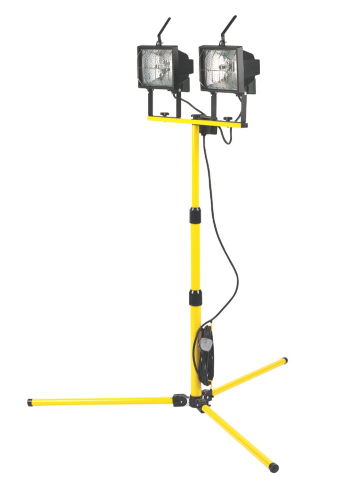

You can just buy some strip lamp holders and fit to the ceiling, then wire them with flex to a 3pin plug. Cheap as.
Or if you want posher, go for site lighting (240v)
http://www.screwfix.com/c/electrical-lighting/site-lights/cat840794
eg for £23:
http://www.screwfix.com/p/double-tripod-site-light-2-x-400w-240v/71555

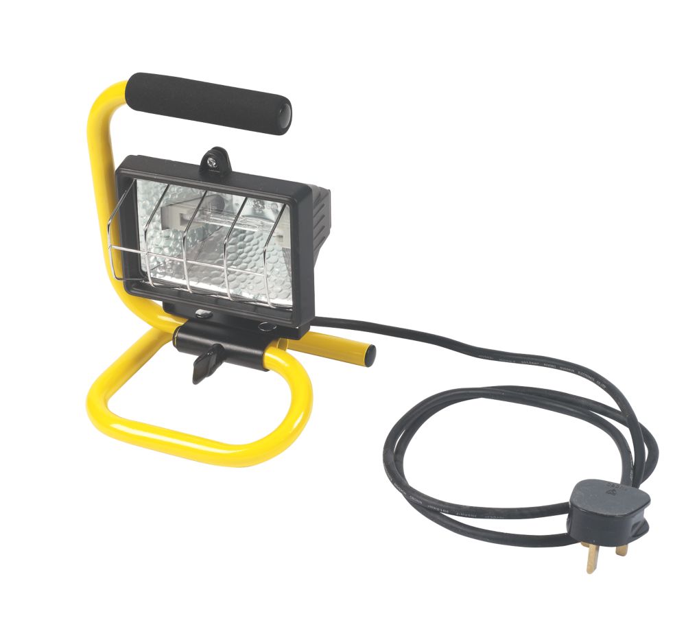

or jerry-rig a couple of these to the ceiling, or on shelves.
http://www.screwfix.com/p/portable-work-light-120w-240v/55370
Those Screwfix sitelights are what me and my colleagues refer to as 'broken lights' they're a catastrophe straight out of the box. In the short period between them being unpacked and broken they're also very good at setting things on fire. They also suck a lot of power so you need thicker extension leads (and if you coil the lead that'll catch fire too)
Big halogens are far too bright and shadowy and the site light style ones of the floor or on tripods mean you get all sort of crazy shadows and glare.
