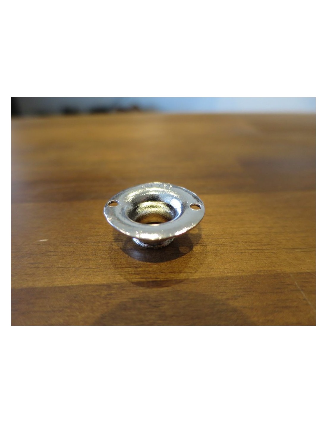

In picking your hole saw - maybe try for a size that you can then fit some sort of flanged spigot into so that if the hole ins't as tidy as you'd like you can neaten it up.
Trying to thing of the right sort of google-able name for that sort of hardware. In a yacht chandlers they'd call it a Deck Bush or a Fairlead
EDIT - actually one of these upside down

That is perfect - thank you 🙂
Also a great deal if I buy another 37 tables.

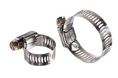

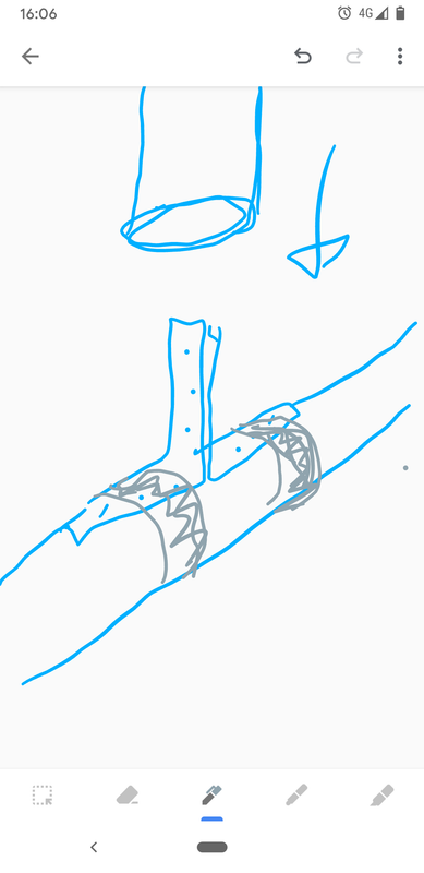

How about this?
Get yourself a couple of angle brackets...
Then get yourself a couple of appropriately sized hose clamps.
Arrange the two angle brackets back to back so you have a vertical post effectively on top of that central brace rail(you could even sandwich a small bit of wood between depending on parasol post size)
Get your hose clamps and clamp each bracket down each side (you could spray it all black so it looks all nice)
Then drill your table as above, insert the parasol through the hole and over the post you've just made.
If the table is nice and heavy you should be all good. Make the drilled hole very near to size and the post sized or shaped with added wood to reduce slop.
